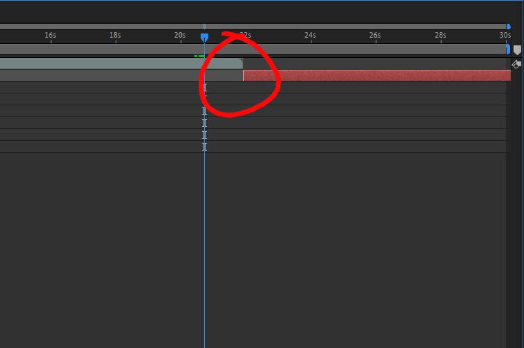

Dear community,
I came up with an idea to push a layer on the timeline in after effects to the location where another layers out-point is.
This would allow me to dynamically push layers on different timecodes just with the information of the layers that need to be updated every single time the template is used. This week the clip is 10 seconds long, the next time it is just 5 seconds long.
But the graphic, which shows after that clip, is every time at the end of this clip.
Is there an expression to get this done?

Perhaps it would be possible with time remap? You have the keyframes where the graphic is and just push those keyframes to the outpoint from the layer that gets changed.
Thanks for some feedback.
