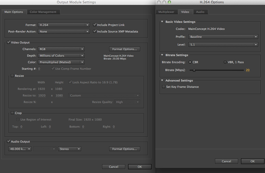

I had the same Errors. With "Warning: Output file will be resized from 1920x1080 (1:00 PAR) to 320x1080 (6:00 PAR) to meet format constraints."
I figured out that the Video setting had slipped.
I found tweaking them worked. Current using these attached. Now the the error doesn't show up.
I have no idea if these are the right settings.
