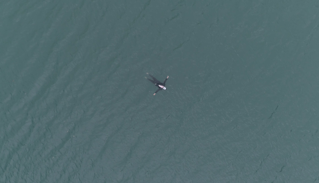

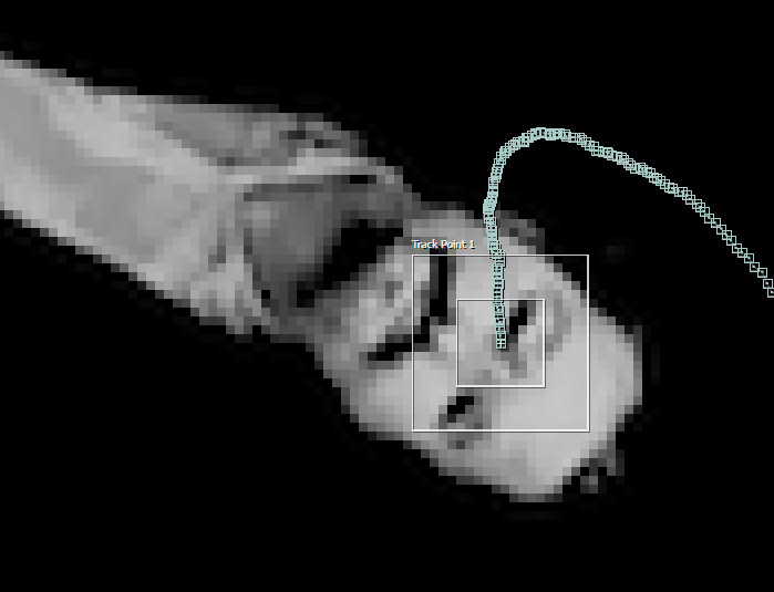

this is a typical frame I'm trying to stabilise. All I'm trying to do is keep the floater in the centre of the frame, so that I can comp it into a wider shot.  I'll have other hudles to jump once I've done this but this is the first step.  I've been tracking a super contrasty verision of the shot (below)

Remember what I said about the detail you are trying to track is probably too small. The footage may be on an SSD but there is a huge difference between Raw footage from a Red or Lossless from a Sony F7 and what looks to be drone footage. That, what I assume to be compressed footage from a drone is going to require a lot more pixels to track and keep stable. The default feature search size is 20 X 20. If that gives you a confidence of 90% then increasing the feature size to include twice that much detail that is basically not moving is going to increase the confidence factor by close to 10%. It's simple math.
I checked your screenshot and the big one appears to be scaled down quite a bit. Comparing it with the closeup showing the tracking I get hardly any detail in the face. If all the detail I had to work with was in your wide screenshot I'd set up tracking like this:

I would at least track the whole face. Tracking will take a little longer but it's worth it. I hardly ever motion track with a feature size smaller than about 40 X 40. I would probably include at least the entire head unless it is moving around. The larger the feature you track the more accuracy you are going to get.
