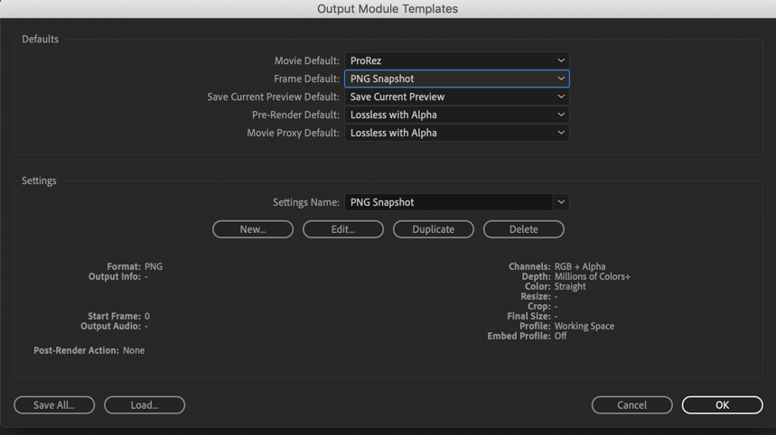

They are only stored in memory. If you want to keep a frame you'll have to use the Composition>Save a frame as Menu or look for a script to speed up the process. I just saved an output module template and set it as the default for Frame:
You can then just press Alt./Option + Ctrl/Cmnd + S to add the frame to the render cue and then press enter to render it.
