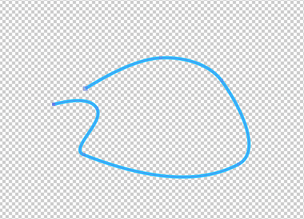

I am not sure whether it is the update or the pen tool looks a bit different. Before this,I can change the linewhen i make a curve using the pen tool. But recently, I am unable to do so because the adjustment line that usually appear when i make a curve line seems to be missing.
If anyone can explain how to fix this, i really appreciate it. Screenshot 2021-06-15 at 1.40.25 PM.png

There are two types of paths Bezier and Rotobezier. Check the toolbar. You have a rotobezier path. You can change it to Bezier by going to Layer/Masks and Paths/ and unchecking Rotobezier.

Thank you, it finally work! I did just like you instructed and unchecked the Rotobezier. Looks like I have to learn more about masking and shape layer after this. Thanks once again.
