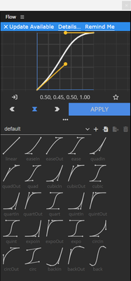

I recently stumbled upon this post that was made in 2013: https://community.adobe.com/t5/after-effects-discussions/bezier-curve-conversion-between-value-graph... talking about the mathematics for converting speed graphs to value graphs. I found the math to be fairly simple for one dimension, but with multi-dimension calculations, specifically in python, my curve values don't seem correct. The author hagmas provided a solution in which I tried to implement, but it seems incorrect when I run my own numbers.

When doing this same scenario in After Effects and reading the graph value from the AEScripts flow plugin, it shows me this graph result:
The y-value of the left bezier should really be closer to 0.447 for accuracy, but it's being rounded in the plugin. Here is the speed graph view in AE:

New Here ,
Feb 26, 2025 Feb 26, 2025
Hi tate,
Thank you, I was able to solve this issue. I found out that I was reversing the in influence and out influence, so the results were flipped. In addition, I took into account the max value of each dimension into the bezier handle calculations.
