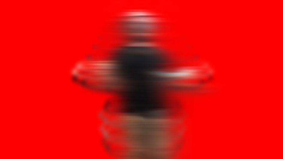

Hi guys.
I filmed my actor on a green screen spinning a lot, then I speed up the clip in after effects, but I would love to achieve an effect like The Mask, when he's spinning with that kinda motion blur.
Is there any way I can achieve that ?
Thanks.

what Op is saying is that it is the video itself is in need of MB, not keyframe animation - so native MB won't help here, it needs a MB type of an effect like CC Force MB or Pixel Motion Blur. I recommend you use Pixel Motion Blur effect which is more aimed to work on video (than CC Force MB which is more aimed to work on effects) although both can work on video.
here's a video about pixel motion blur effect: https://www.provideocoalition.com/pixel-motion-blur-in-after-effects-cc/

as Warren said, Native MB won't help you with video (or effects). there are other effects you can try like CC Force MB. here's a tutorial for a similar effect to the one you are trying to create
Contributor ,
Oct 16, 2017 Oct 16, 2017
THANK YOU ALL for the replies !
Curios you guys mentioned that clip from Film Riot, because that's what I'm doing, a contest for them.
Anyway, I solved it by cheating with lots of tricks and I got this:
Pretty happy with result
