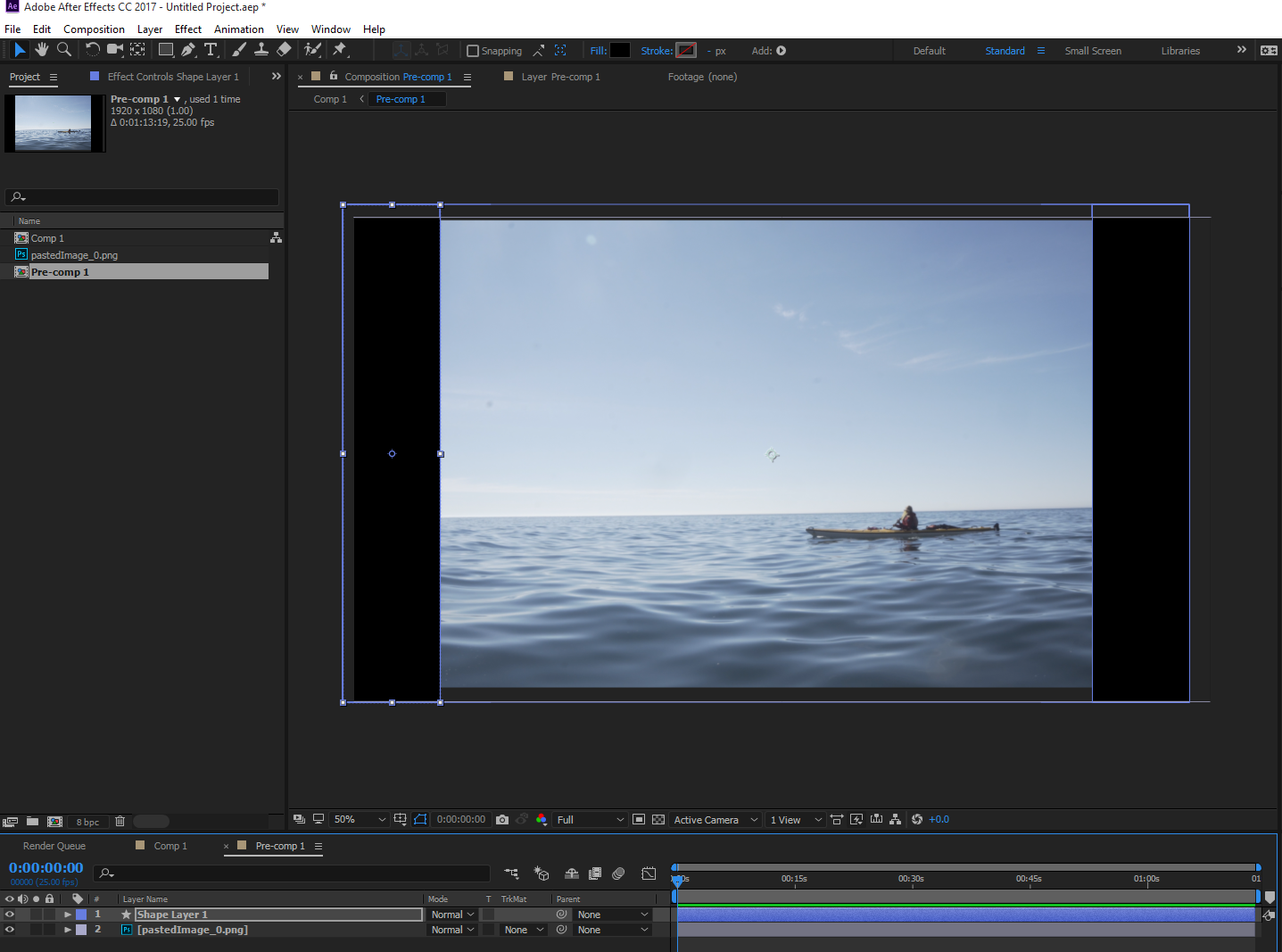

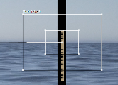

a neat trick to solve horizontal horizon track shots is to create two static features at each of the sides.
something like this:
now precompose and stabilize this:
here's the technique using lines in fusion. not sure lines are better but test for yourself

Yes - good idea from Roei.
My guess is that the outer 'search area' box on your track points aren't tall enough to cover your movement - you can resize them.

I saw that video, and I made shape layers in after effecs, however once I press the "stabilize motion" the shapes disappear and the footage goes back to its original form.

I think this should track OK just using the horizon - it's nice and clear.
1. Make the outer tracking boxes taller.
2. Click the options button near the bottom of the tracker panel and make sure:
channel = lunimance - or you could try RGB as an alternative
enhance before match = off
subpixel positioning = on
Adapt feature on every frame = I'd suggest OFF from the image you've posted

you should precompose the footage with the shape layers. otherwise Ae will track just the footage. select all the layers and go to Layer-precompose. now on that precomp stabilize the motion.

of course you do have a lot of shaking going on there, not just the horizon. the camera is moving a lot and if you want to focus on the and you need to trim the shot to just the part you need to track. this needs work, no easy stuff.
so you can precomp that stabilized horizon, and now you can track just the boat so it will be centered in frame. you can stabilize just the X so the camera won't shift so much.
