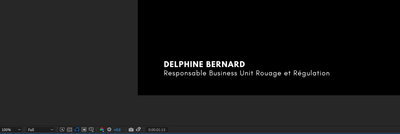

I had this job, where i made lower thirds for a corporate video we shot. I never encountered any problems with previous Lower Third packs I used to buy, but since doing them myself, no matter what a I do, my text and titles look rigid and jagged.
I used a plugin called FXAA as well just in case this was a Anti-Aliasing problem. It helped a bit, but if I used it too agressively it would bleed out and make my text Fuzzy.
Q: How can I make my text to be as sharp as for example .ai text files or at least other AE Lower Third Packs?

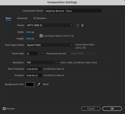

PD: Here are a few Settings on the Comp.
Export Settings:
Thank you in advance!

DaVinci interpret footage correctly but FCPX not, this is whay I'm asking you. What you can do is not to use Animation as the codec for render. Animation is an 8bit format and can cause some artifacts. Change your project to 16bpc, and use ProRes 4444 as the codec for the output file. Also change your output module to trillions of colors+.
I've done a quick test right now and it looks perfect in my computer

Nothing wrong here. Within reason of what you can expect from MPEG-compressed footage this looks perfectly normal and al lthe mucking around with extra effects won't do much. You may just never have noticed it before because your footage was different or whatever templates you used had other stuff going on that distracted from the problem. Also your type is very perepndicular, which is always going to amplify alaiasing issues on edges when they are pefectly straight and coincide with the pixel grid. Again, really nothing wrong with your stuff from a technical viewpoint. If at all you could possibly minimize the artifacts by changing the design like adding the faintest bit of a dark outer glow or making the white more of a bright grey to minimize the sharp contrast that may cause artifacts just as well as you may be able to improve the look by slightly changing the position of the text, but overall you have to accept this. Only uncompressed output will ultimately look sharper, but that doesn't do you much good when uploading to YouTube or whatever and it compresses your video, anyway.

I did all the previous settings when I worked on the video.
I missed the Depth from Billions to Trillions+ and that was the KEY.
@Jose Panadero Thank you very much! Now it looks crisp and sharp.
