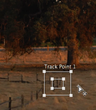

You can put the area of interest, the smaller square in AE's tracker, on any detail then carefully move the attach point to another location to offset it. I do that all the time. The cursor will change from a large + to a small one like this:
vs
You should be able to use the connecting lines between the attach points to line up the edges.
The replacement footage is going to be the size of the layer so the best thing to do to keep it from being distorted is to measure the aspect ratio of the matte,
Sep 20, 2018 Sep 20, 2018
vs
The replacement footage is going to be the size of the layer so the best thing to do to keep it from being distorted is to measure the aspect ratio of the matte, create a comp that is the same aspect ratio, then insert your replacement footage into that comp and let it crop if it has to. That will keep the footage from distorting.
I would probably use Mocha instead of corner pin tracking for that shot. I have developed what I call advanced corner pin tracking using Mocha, CC Power Pin and corner pin that makes the roto easier and allows a lot more control. It's pretty easy to do. Here's a demo of the technique.
