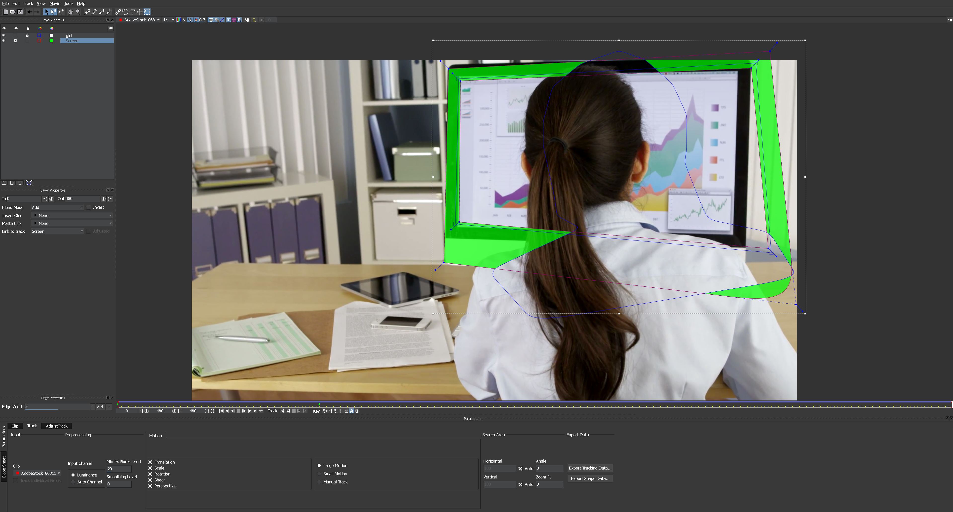

I'm trying to track below with Mocha. I've seen tutorials and nothing seems to be as smooth as Iv'e seen on you tube.
I'm curious on what certain lines are.  I know the x-spline (Red) and "show planer" (Blue) and try to understand what they do. I'm trying to replace the screen with an image. What would be the best way to track this in mocha?
Please help! I have to turn this in tomorrow with out hours of constant correction.

The Red lines are the shapes where mocha looks for transformation (tracking data). The planar surface (blue lines) is the corner pin data. By default Mocha assigns the movement of the shape tracking data to the planar surface, but you can change the planar surface movement inside the Adjust Track tab.
Anyway, I recommend you to learn the basics of Mocha. Borisfx.com has a lot of tutorials in their website. It is a very recommendable resource.

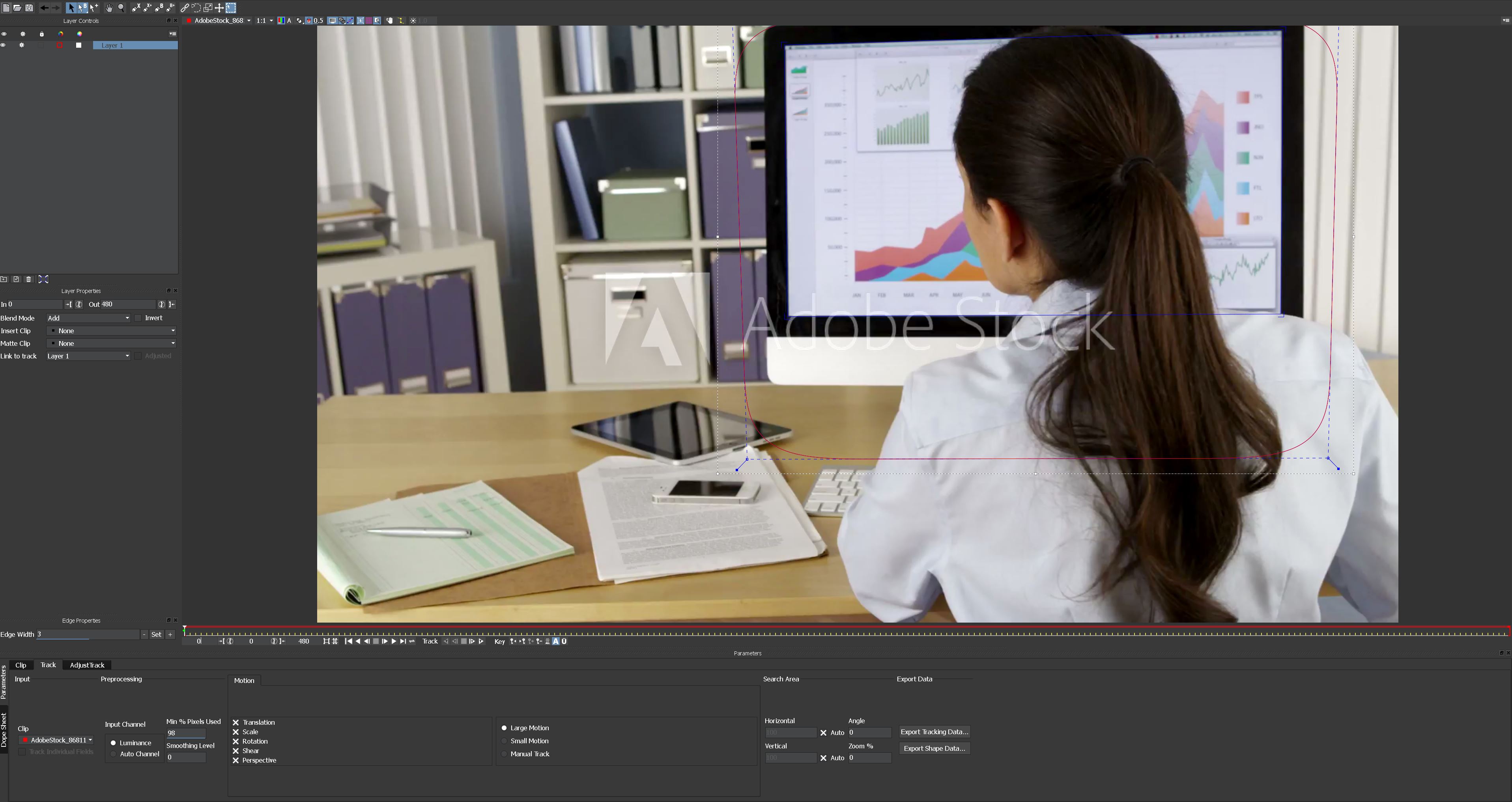

Also what about the adjust track? Ive tried to correct the drift, but there I end up using multiple reffs. Should use just one reff or keep adding new reffs?
Feb 26, 2018 Feb 26, 2018
Take a look at this tutorial. It quickly shows you how to use a track matte in Mocha. This is the technique you should be using for this shot. I should emphasize that each shot presents different problems and each problem may require a different technique.
I tried your shot and got a good result with the following setup. Added a spline around the entire screen keeping it close to the edges of the computer. Added a second spline to the screen layer inside the frame that was just smaller than the screen. Added a new layer for the girl. Manually tracked the girl using just a few keyframes because it was faster than tracking her. Set view matte, edited matte color and set the matte mode for the bottom layer (screen) to track matte. I got a decent track with only 2 keyframes. Checked it using the 16 X 16 grid.

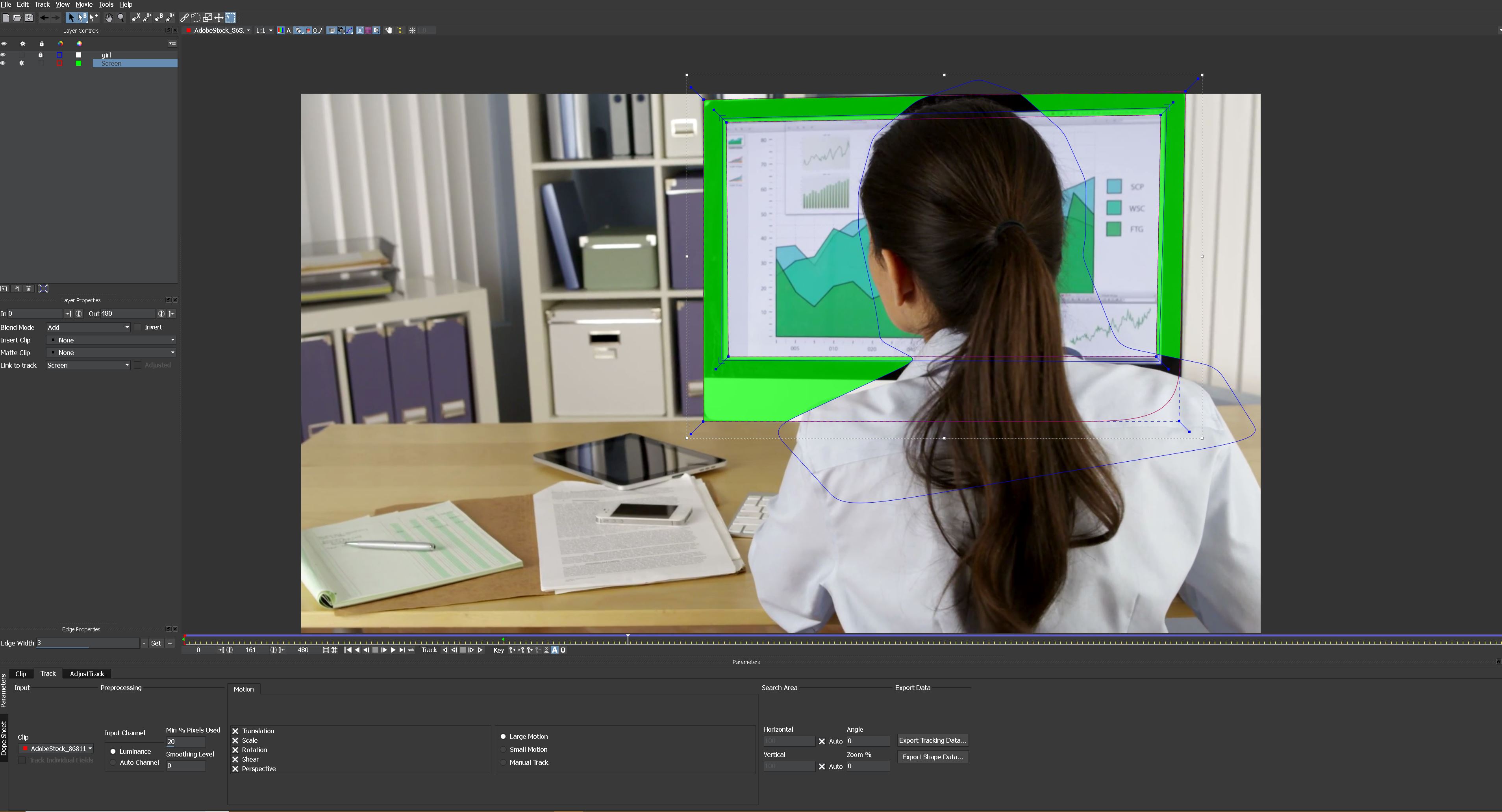

Feb 27, 2018 Feb 27, 2018
Hi Rick,
I have imitated what you have done and it seems to be slipping around hereCapture.JPG
Could the mask around the girl be throwing it off?
