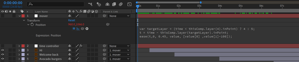

I sure hope I'm barking up the wrong tree with my approach and that there's an easier way to do this.  All my current attempts are failing.  I've got a bunch of layers parented to a null object so that I can use the null object to scroll them up the screen.  I want to incrementally scroll as the composition time hits the inPoint of each child layer.
In the transform position expression of my null object I have the following:
//basic example, select the index of either layer 4 or 5 depending on if the time is before the first one's inPoint or not
startIndex = (time<thisComp.layer(4).inPoint) ? 4 : 5;
//use the inPoint of the currently selected layer based on the statement above
startTime = time - thisComp.layer(startIndex).inPoint;
//only scroll up
ease(startTime, 0,0.45, value, [value[0] ,value[1]-100]);
I can verify that during playback, the correct startIndex gets selected over time. I can also verify that startTime hits 0 at the inPoint of layer 4, then goes below 0 and hits zero again at the inPoint of layer 5. However, the value graph (and animation) only ever execute the Ease function for the inPoint of layer 5 (the default of the if statement). Any ideas?

Thanks for having a look.  Sorry, my variable names must be confusing you.
My startTime variable holds the time I want the animation to start, which is the inPoint of the targeted layer.
My understanding is that to trigger an expression based on the inPoint of a layer you would set the time of the ease to:
t = time - inPoint;
That's what I'm doing here, except that I've confusingly named my variable startTime, instead of t.  Either way, it doesn't work.  Also instead of using the inPoint of the current layer (a null object), I'm using the inPoint of a different layer (one of the children).  I can verify by outputting the value that I'm getting the correct inPoint time from the child layer, and the ease function runs just fine.  Problem is, it only runs once and I want it to run multiple times since over time it will hit multiple inPoints of other layers.  In the example above, it only ever runs the last one (layer 5) and skips layer 4.

For reference:
Aug 01, 2020 Aug 01, 2020
If I understand this correctly you are animating position based on the in and out point of a bunch of other layers. That's going to get really complicated and recursive very quickly. My approach would be to use one expression for the position that looks at the position of the layer above (index - 1), adds the height of the current layer to the position plus and offset, and then relies on the in point to make the move happen. I have about 40 auto move presets that just rely on lin and out points of layers to animate position. All you do is put the layer in its hero position, set the in and out point, and then moves into the frame then moves out before the out point.
I don't have time to write it for you but if you are fairly good with expressions you should be able to figure it out.
Edit. The previously posted expressions were a good starting point but this one will move a new text layer below the current text layer above it over 20 frames. I did have some time for fiddling around while waiting for feedback from a client.
