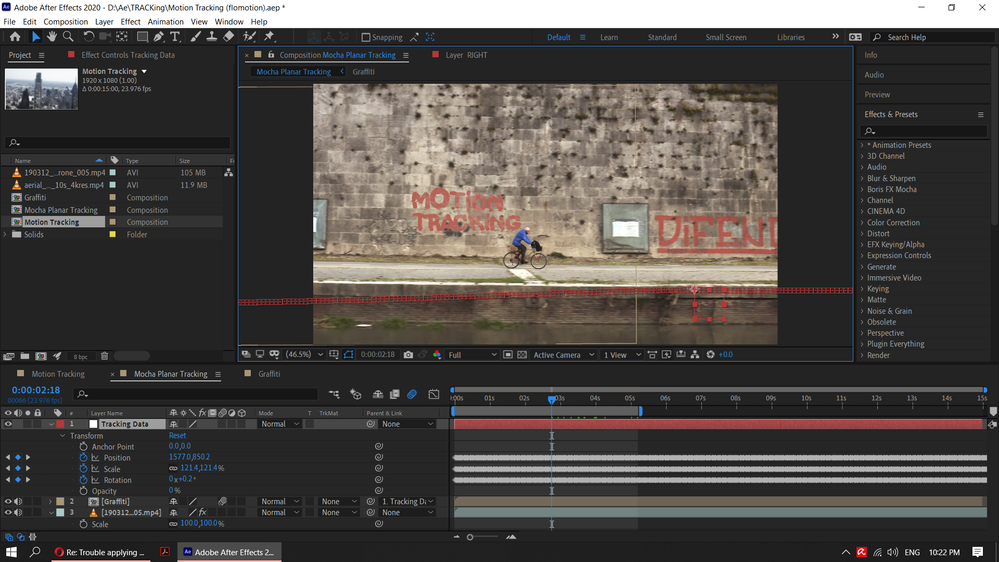

Hi, dear community,
I'm trying to apply a 4-point motion tracker in Mocha to a "Graffiti" I drew myself in AE.
The 4-point tracker looks fine, ... and DISAPPEARS after FRAME 185! (out of frame)
When I apply it to a Null, which I then use to be parented to the 'Graffiti' ... it gets all funky.
I'm losing my marbles over this ...
Ths heaps in advance,
Sandro

If you have not scaled or repositioned the layer that you tracked in Mocha AE the null should attach to the center of the surface you created in Mocha. I'm not sure where your workflow went wrong. To make sure that the latest release of AE doesn't have a bug I did a quick test. Here's a speeded-up over the shoulder. I always turn off the spline visibility, add a surface, and usually one of the grids when I'm tracking in Mocha so I can have a really good look at the track. Maybe this video will g
Jul 14, 2020 Jul 14, 2020
If you have not scaled or repositioned the layer that you tracked in Mocha AE the null should attach to the center of the surface you created in Mocha. I'm not sure where your workflow went wrong. To make sure that the latest release of AE doesn't have a bug I did a quick test. Here's a speeded-up over the shoulder. I always turn off the spline visibility, add a surface, and usually one of the grids when I'm tracking in Mocha so I can have a really good look at the track. Maybe this video will give you a hint. I tried to include everything I did.

Dear Rick_Gerard,
You are and absolute AE-whizz-genius.
This is wayYy more than I bargained for: Thanks so much for both the actual solution to my problem-ôh
   ----> SCALE 50% <-----
SCALE was the VILLAINSCALE was the VILLAIN
and your entire workflow. Learnt some extra tweaks and ideas therein too.
HOW can I SCALE a CLIP, TRACE it & create a NULL for it WITHOUT RUNNING INTO THIS IMPASSE?
Greetings from Switzerland,
Sandro
Jul 15, 2020 Jul 15, 2020
Pre-compose the layer before you run the tracker in Mocha or Do everything in a larger comp and scale it down later.
