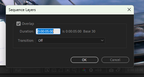

If you want to add lots of images, the Animation > Keyframe Assistant > Sequence Layers can help.  Just add all your images, select them all and trim them to 10 seconds (?) - the ] key can set the outpoints.
Then copy the warpomatic effect to them.
You will have to go into each image's effect and change the layer to reveal.
Then use Sequence layers with an overlap of 5 seconds and the layers will be spaced out along the timeline.
Community Beginner ,
Oct 02, 2024 Oct 02, 2024
This is so great of you to show me this many thanks! So with this method you get a kind of rippling/warping between each and every frame? as they blend/overlay each other. I will try this to see if its the look i am after.
