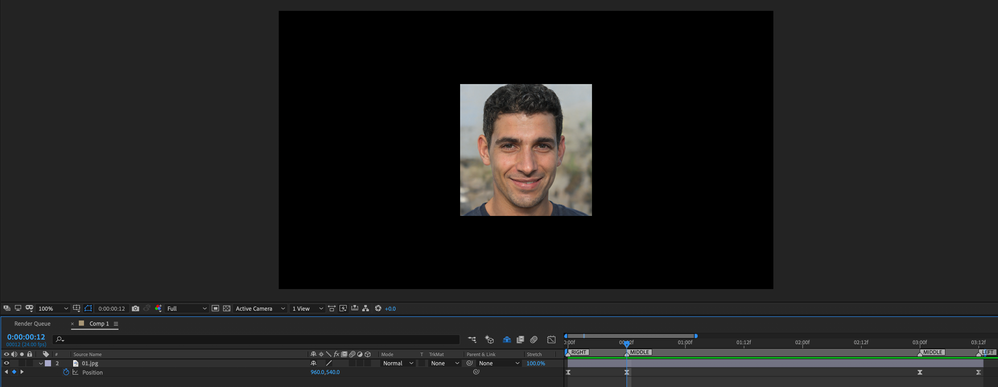

Community Beginner ,
Feb 07, 2020 Feb 07, 2020
I would do something like this:
  1. Move the picture to the right side of the composition and create a keyframe.
  2. Move the picture to the middle of the composition or the position you want it to stay and create another keyframe
  3. Advance in the timeline the amount of time you want to see the picture and create another keyframe in the same position as the last one.
  4. Move the picture to the left side of the composition and create a keyframe.Screen Shot 2020-02-07 at 09.58.47.png
  5. Duplicate the layer and move this layer formard in time until the two last keyframes of the first layer overlap the first two keyframes of this duplicated layer.
  6. Drag a picture from the project files window holding the Option key (or ALT in Windows) and release it in the composition window. This action will replace the picture.
Screen Shot 2020-02-07 at 10.07.03.png7. Repeat the process as many times you need.
I hope this helps.  Cheers!
