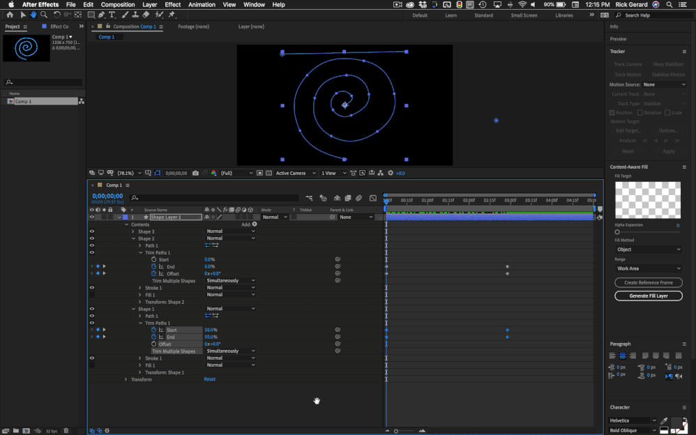

Trim Paths give you the ability to animate the start and end of a line as well as the offset. The start and end values are percentages so the math is easy. An offset of - 180º makes the start or end animation begin exactly halfway through the line.
By far the easiest way to have a line form from both ends and meet in the exact middle or grow from the middle is to animate the End from zero to 100% and the offset from 0º to -180º to make a line start at the end or animate the Start from 100% to 0% and the Offset from 0º to -180º.
The other way would be to animate the Start from 50% to 0% and the End from 50% to 100%. Either one of these techniques will do what you ask and you can offset the meeting point or starting point by simply adjusting the percentages.
