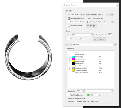

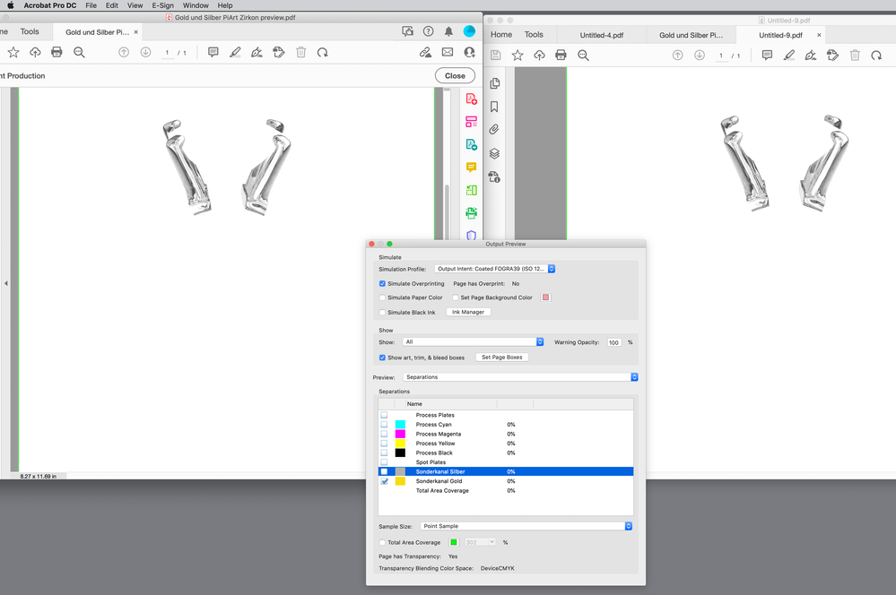

Thanks for getting back to me, here is one of the individual channels:
The PDF you can take a look at here https://drive.google.com/file/d/1avJafZKE4AkjPrm64zFMzHN_1LTQbiu_/view?usp=sharing
Maybe you can see something I missed or did wrong.

I can’t see a problem. Have you shown them screen captures of the two spot plates from your AcrobatPro?

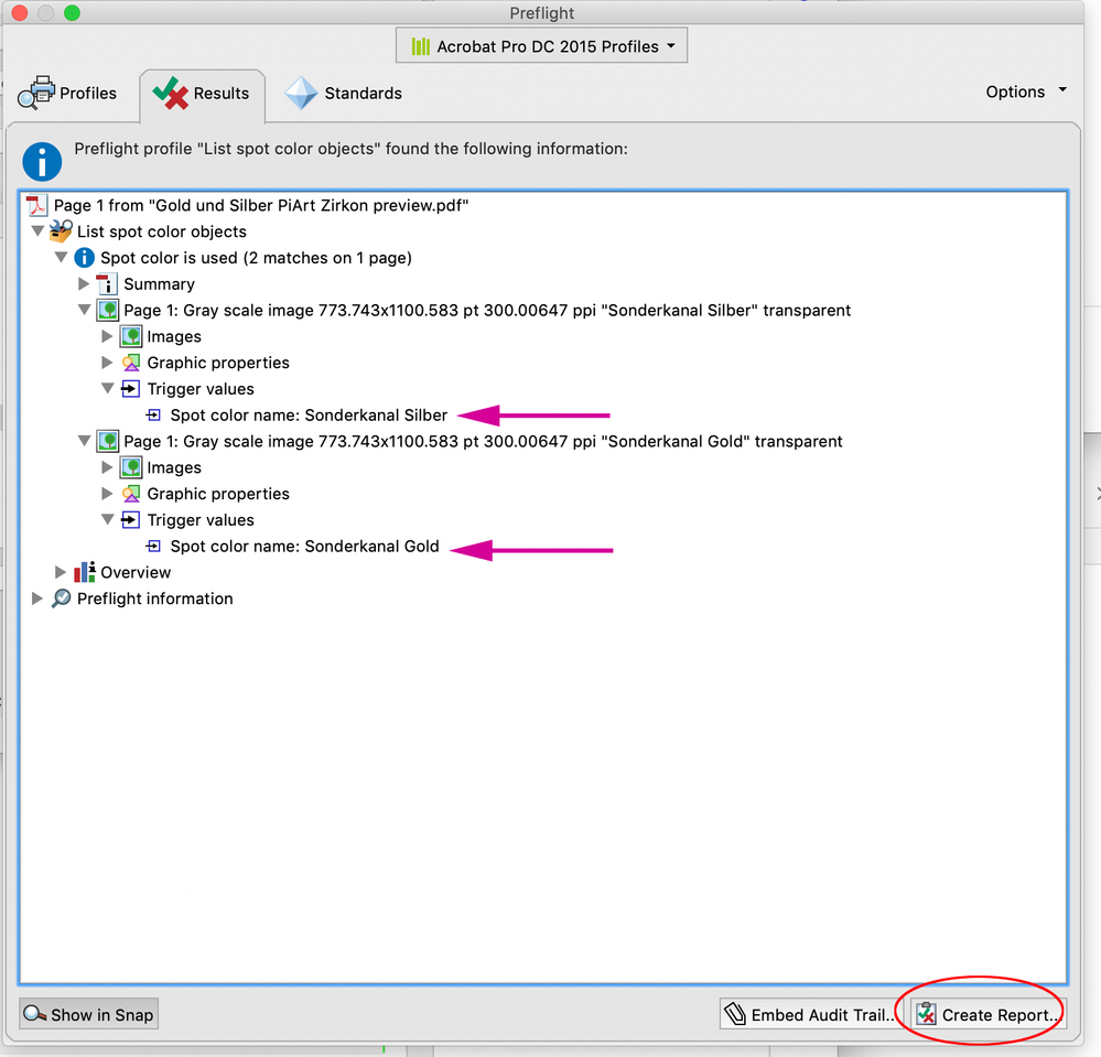

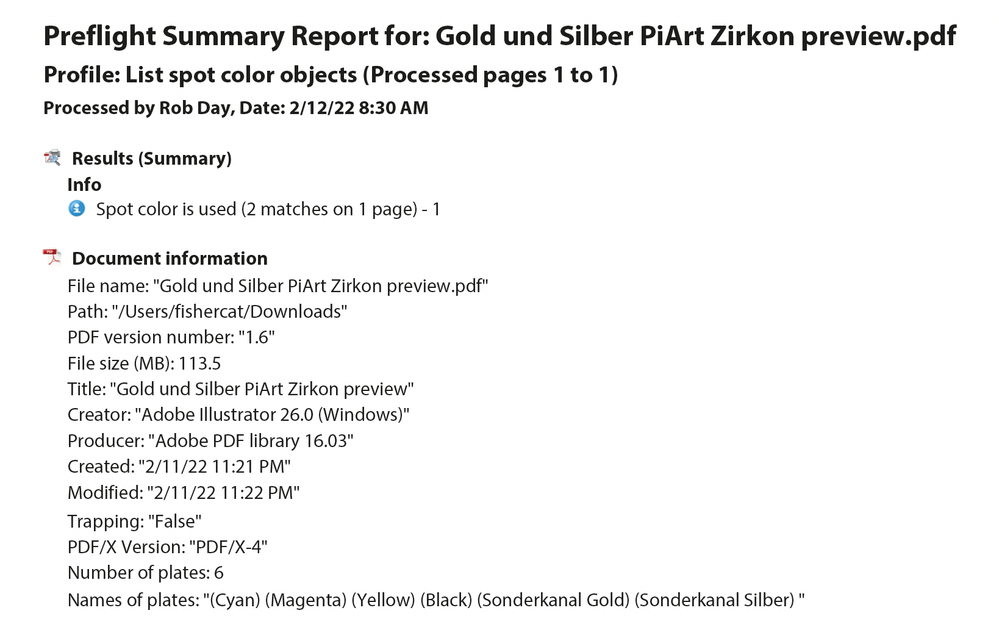

AcrobatPro’s Preflight is showing the spot plates. You could create a report and send it to them or ask them to run a preflight and send you the report:

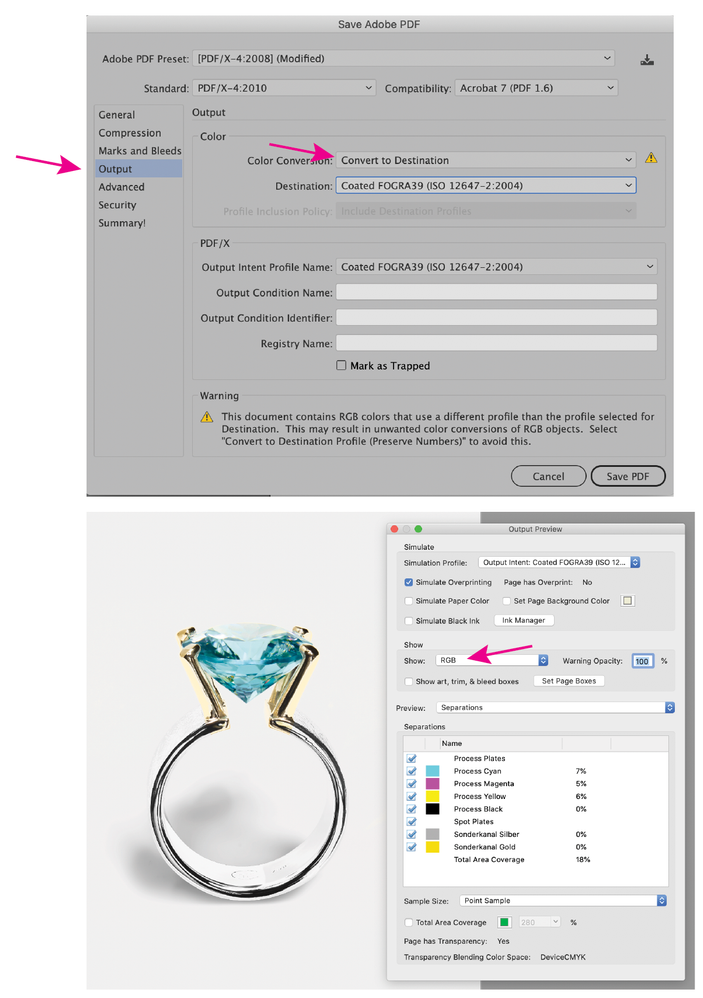

A PDF/X-4 export with the Output Destination Profile set to the Coated FOGRA39 output intent would make the PDF CMYK + Spots.

PDF/X-1a exports the same separation numbers, but flattened and as CMYK+spots. X-1a on the right:

Preserve Numbers only applies to native InDesign CMYK swatches and colors when you are converting to a CMYK destination, which conficts with the document’s assigned CMYK profile. Your file includes an RGB image, transparency and spots, so the RGB image values have to be converted when you set the destination to Document CMYK.
Copy link to clipboard
Copied
Just to be clear, PDF/X files can contain RGB, you need to Convert to Destination in order to have a cmyk file.
Generally a printer would not have a problem with an RGB file, but this press might be particularly touchy or it has not been set up properly.
The Output Preview tool in Acrobat will show you all colors by default and show cmyk separation values when the Simulation Profile (at the top of the panel) is set to a cmyk output intent (also the default). To confirm your file is cmyk, change the "Show" color to cmyk.

X-3 flattens, so maybe it is the mix of transparency and spot color? It looks like@YAID3d ’s PDF has the spot colors assigned to a grayscale Multiplying over the RGB image, rather than Spot channels in the RGB image where there would be no need for transparency effects?:

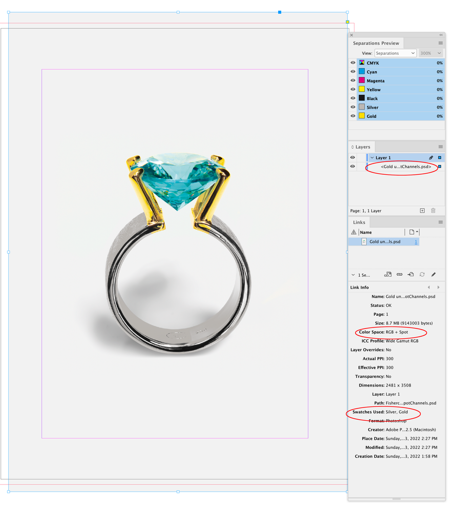

It looks like @YAID3d composited the spot colors with InDesign using three different files with transparency effects—you can’t overprint a grayscale, so I assume thta’s the reason for Multiply?
I think the more typical way to do this would be to add the spot inks to the Photoshop file as Spot channels, where there would be no alignment issues and some crude color management for the spot percentages and overprints. This InDesign page has the two spots coming in with the PS file, and no transparency:
