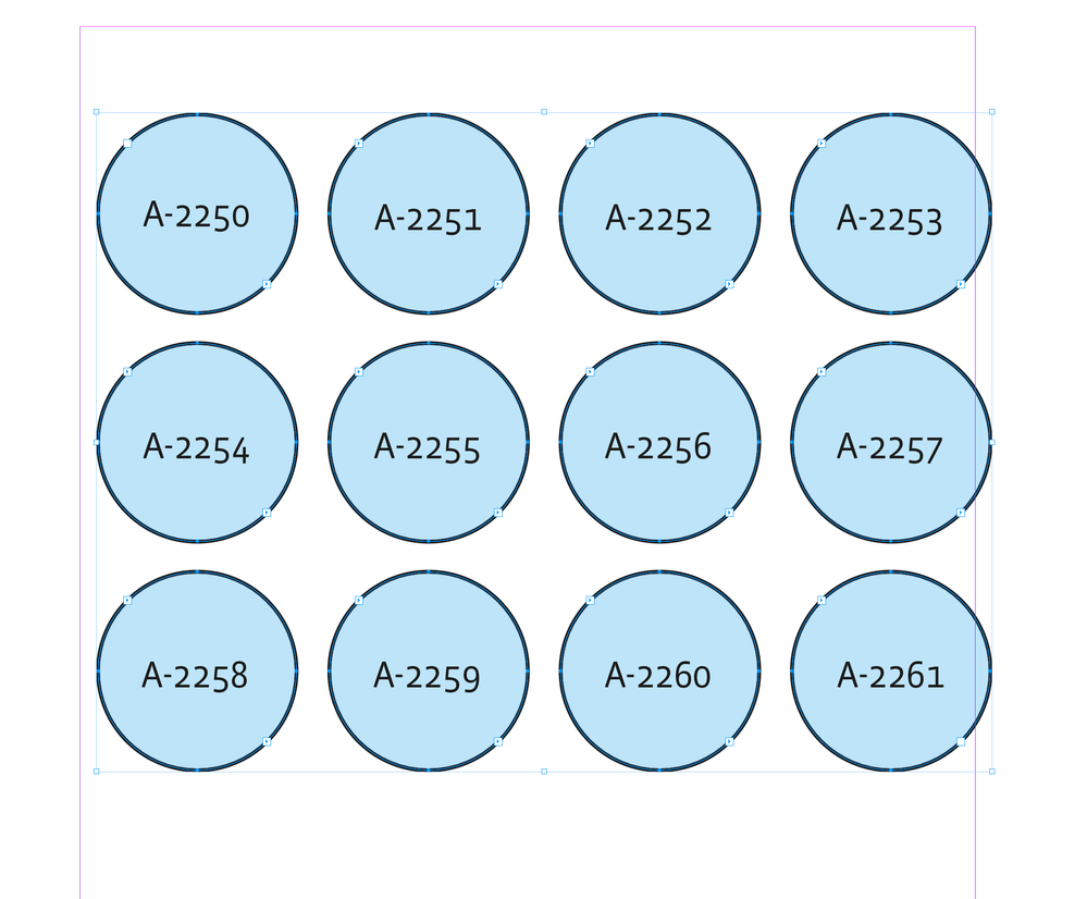

Hi @Bedazzled532 , I think you will have to add the Frame Break character after you insert the counter string, something like this:
function threadFrames(){
    var frames = app.selection;
    var counter="A-";
    var counterPart=2250;
    for(i=0;i<frames.length-1;i++){
        frames[i].contents =  counter+counterPart;
        frames[i].insertionPoints.lastItem().contents =  SpecialCharacters.FRAME_BREAK
        frames[i].nextTextFrame = frames[i+1];
        counterPart++;
    frames[frames.length-1].contents=  counter+counterPart;
app.doScript(threadFrames, ScriptLanguage.JAVASCRIPT, undefined, UndoModes.ENTIRE_SCRIPT, 'Thread Frames');

Wow. This is actually what I wanted. Thanks so much.
I wasn’t trying to re write or develop your script, but with the code you provided setting the contents to include a frame break didn’t seem to be working, All I did was ensure that it was added at the last insertion point of the frame you were threading. Also the IDML you provided seems to be setting the text RTL, so you might have to consider that.
