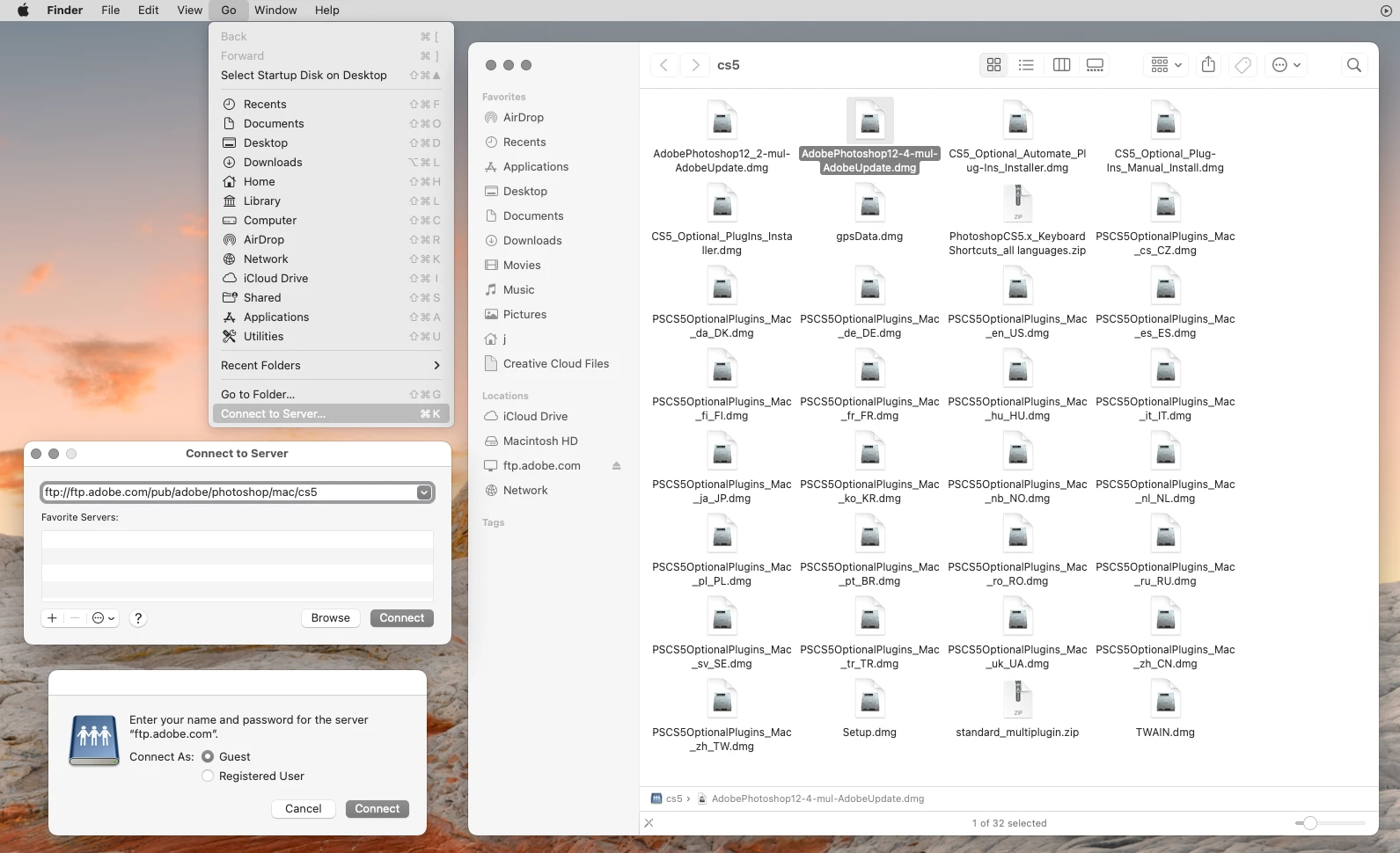

Is there a current link to Photoshop CS5 12.0.4 for Mac?
Hello! I'm trying to solve a printing issue where Photoshop crashes every time I try to print. I currently have Photoshop CS5 Extended version 12.0 x64 and I'm running MacOS High Sierra 10.13.6 on a Macbook Pro. I saw a post here that updating to version 12.0.4 might resolve the issue, but the link on that page was dead. I also found another post with an updated link in the comments, but that one didn't work either (it brought me to an FTP that gave an error message: There was a problem connecting to the server "ftp.adobe.com". The share does not exist on the server. Please check the share name, and then try again.)
I spoke to several Adobe representatives, but none of them were able to provide me with a link to the update so they recommended I post here.
Does anyone have a link to Photoshop CS5 version 12.0.4 for Mac?

Jeff ArolaCorrect answer
May 24, 2022
Sometimes you have to try Connect To Server several times or maybe another time of the day, but it should eventually connect and then drag the AdobePhotoshop12-4-mul-AdobeUpdate.dmg to your desktop.
Also use Connect As>Guest
To install the 12.0.4 update you may have to use the procedure listed here under
Creative Suite 5.5, 5, and 4
https://helpx.adobe.com/creative-cloud/kb/install-creative-suite-mac-os-sierra.html

Jeff Arola
May 24, 2022
he_draws
he_drawsAuthor
May 24, 2022
Thank you SO much! Although I had tried connecting to the FTP as a guest before unsecessfully, it worked this time. I followed the steps to install 12.0.4 and now Photoshop prints without crashing! You're a lifesaver.
