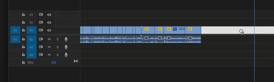

Same issue, just editing a rough cut that I started last week.  No problems last week, now I can only drag audio in.  See screenshot, the last clip is when I try and drag in video.
Have tried dragging video, adjustment layers and more to the timeline, audio is fine but video is a no go.  Gonna restart and if that doesn't work rebuild the timeline...  other timelines in the same project seem to be fine?

Restarted, no go, as a thought, I duplicated the timeline, still no go.  I then CTRL+A selected everything and deleted it...  and all of a sudden I can drag videos in just like normal!
So I undo'd the delete, and deleted the clips one by one to see if they were causing a problem.  I deleted them all out one by one and the issue persisted where I can't drag videos onto the timeline...   CTRL+A and DELETE again, and the timeline works just like it should...
so so weird.

I Use another workaround: Select the target track before dragging your clip there. It usually works.

Doesn't work for me - see below.  I get the forbidden sign with the hand even with the track selected.  Still got the original nonworking timeline so happy to try any other ideas people get!
