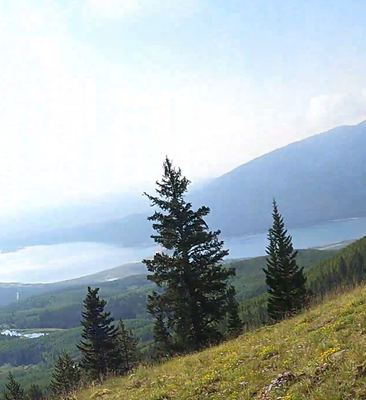

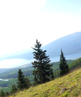

No matter what I do, all my video exports have poor quality. Here's an example frame from the exported video, which is gross and pixelated:
Roughly the same point in the original video:
While the sequence consists of many videos and photos, the above video what was initially dropped into the sequence, so the sequence should have used this video for its default settings.

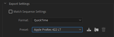

As a test, how does it look if you export it to ProRes LT?
Make also sure that your footage is not variable frame rate. Use the free Shutter Encoder encoding|converting video FREE PC|Mac to convert the footage to constant frame rate.

Thank you. ProRes LT is not a selection in the Format dropdown:
Traducir
Informe
Directrices de la comunidad
Sé amable y respetuoso, muestra títulos de crédito de la fuente de contenido original y busca duplicados antes de publicar. Más información
Feb 08, 2022 Feb 08, 2022
quote
By @Aren Cambre
Look at the image i posted in my first post: Format=QuickTime, Preset=Apple ProRes LT.

Apologies, I missed your screenshot. OK, I did Format=QuickTime, Preset=Apple ProRes LT as you recommended. Now I have a 38 GB file as opposed to the 1.5-3.1 GB files from prior methods. Even though my computer is fast, it is skipping frames left and right when playing. But per https://en.wikipedia.org/wiki/Apple_ProRes, it appears that given the intended use of ProRes, I shouldn't be alarmed by the frame skipping.
I paused on what may be the same frame as my initial screen graps, and quality problems are gone:
I sampled stills throughout the video and found no quality issues.

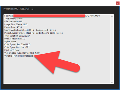

Oh, it looks like GoPro might use variable frame rate? https://www.reddit.com/r/gopro/comments/mqgras/variable_constant_frame_rate/

Yes they often do and so do smart phones. Look in your Project panel in Premiere Pro and look at the frame rates under the Frame Rate tab. This is an easy way to see if they do or don´t.

Thank you. All my GoPro videos (.mp4 extensions) are 29.97 fps. Also, if you go back to the top of this thread, you'll see that the properties of my intro video do not indicate a variable frame rate. This to me seems to suggest my GoPro videos do not have VFR.
My iPhone videos (.mov extenstions) range from 30.00 fps to 60.01 fps with several videos having random-ish fps values in between. Also, sampling various iPhone videos, some but not all have a "Variable Frame Rate Detected" indicator in the video properties. Example:
The weird thing is the video I've been doing the screen grabs from is a GoPro video. As per its properties on the screenshot at top, it is not VFR. Why would it have poor quality?

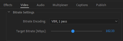

Thank you. Is that done through this part of the Export Settings dialog?
This is what I am about to try:

Yes, all settings i mentioned are available in the Export Settings dialog.

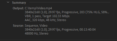

Thank you. The quality has improved from horrific to middling:
Per several sites, inclduing Adobe (source), it appears the max bitrate you'd ever apply to a 4K video is 56 Mbps. Since I did 100 Mbps target bitrate and still get significant compression artifacts, are there other measures I can take to further improve video quality? Or is this a "get over it and nobody will notice it on moving images, you moron" moment?

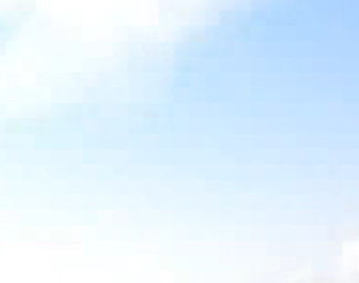

I tried Format=HEVC (H.265), Preset=4K UHD and got results that are slightly better:
I see fewer artifacts. That said, in the sky, I see banding:
Maybe I jsut need to live with it?
By @Aren Cambre
Banding is often due to the fact that the codec is 8-bit in combination with gradients in the footage, such as the ones seen in a sky. Are they already in the source footage they are harder to get rid off. One can trick the encoder by adding noise to the clips. There is a video filter named Noise in Premiere Pro.
Here are many tips and videos regarding how to reduce banding: reduce color banding premiere pro
