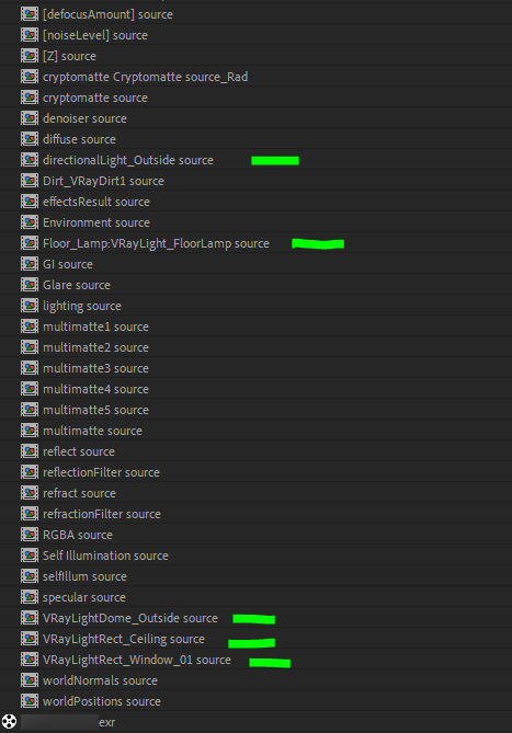

I'm working with a multi-layered EXR file from Maya 2025 and V-Ray 6, I get this following error when importing the file.
The file does then open in AE and all of the passes unhighlighted below open fine, but then nothing is visible in my light mix passes that hold each individual light pass.

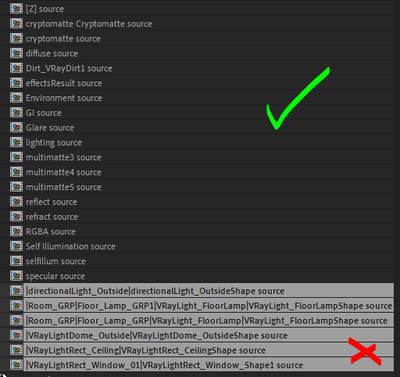

I had created a render a couple of days ago from the same scene (although using a different PC) that worked fine in AE. The only difference I can see is with the naming of the layers that come with the file, on the file that worked those light passes have much simpler names compared the lengthy ones above that show Maya's groups, transforms, and shape nodes. Any idea what might be going wrong here?

For anyone else who is having this issue, I managed to find out the reason why it was happening.
I had two lights set up in Maya that had identical names. As V-Ray's Light Mix element uses each light's name for splitting out each light to a seperate pass, it took each light's group/transform/shape naming to make each one unique, which then made each element's name too long for AE to handle.
I gave each light a unique name and it works perfectly now.
