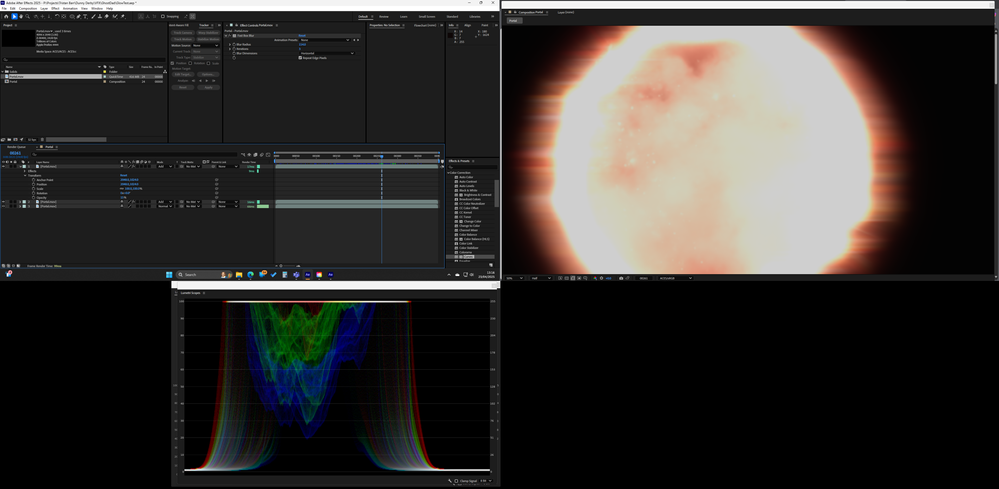

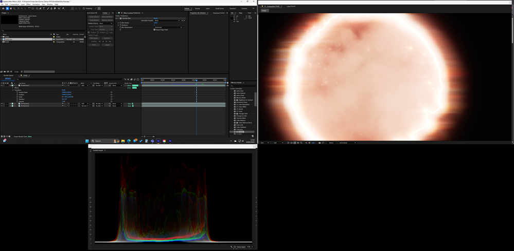

Just upgraded to 25.2.2 and I am having a strange issue with adding layers its like it randomly clips or switches color space from one frame to the next. Only started happening after upgrading AE and NVIDIA.
The screenshots are from the same project just different frames, as you will see it also affects the scopes. Only effect used is 'Fast Box Blur'
Switching to 'Software Only' fixes the issueScreenshot 2025-04-23 131637.pngScreenshot 2025-04-23 131655.pngScreenshot 2025-04-23 131835.png

Thanks for sharing the files and details. I am able to reproduce the issue on my end. However, it's different on my end. The values are clipped the whole time as shown in your screenshot at the bottom. The Scope looks not clipped on specific frame if I change the value of the Fast blur on any layer. If I disable the Fast Blur, it seems to be working fine. I've filed a bug for further investigation. Thanks for reporting.

Here is a better representation on the scopes with the signal clamped. Its clearly clipping on 1, this happens randomly as I scrub the timeline.

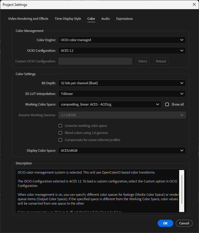

I am working with After Effects 25.2.2, Color Engine OCIO ACES 1.3 Studio v1.0, 32bpc
I have worked with the same color management configuration since ACES was available a few versions ago (two years ago I think).
However, for the past two weeks I have had trouble with the white levels. As soon as I start blending some layers the RGB values start clipping at 1.0.
When I check each layer isolating them, the levels are correct (going over 1 when needed), but when I add the layers, they get trimmed at 1.
