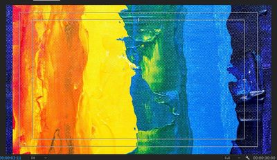

For some reason media encoder changes the position and repeats a section of my composition when exporting.
After effects Preview
Media encoder output
This issue occured when I tired to render the composition in Quicktime Format. It affects the output of the video, and when I try to switch back to H.264, the updated position+repeated edge persist.
I managed to replicate this exact issue with a totally different composition using the same steps which makes me think its a media encoder issue.

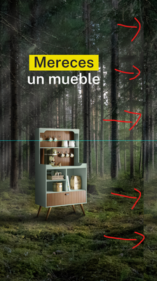

Hello, maybe it's After Effects trick, maybe Media Encoder one, but I have some strange case:  when I create video in After Effects, everything is fine. If I render in right in After Effects the same, all good.
But as soon as I render the same file via Media Encoder, I have some additional part of the video on the side -- impossible to explain by words so I enclose the picture:
Anydoby know what the issue is that ?
Thanks !

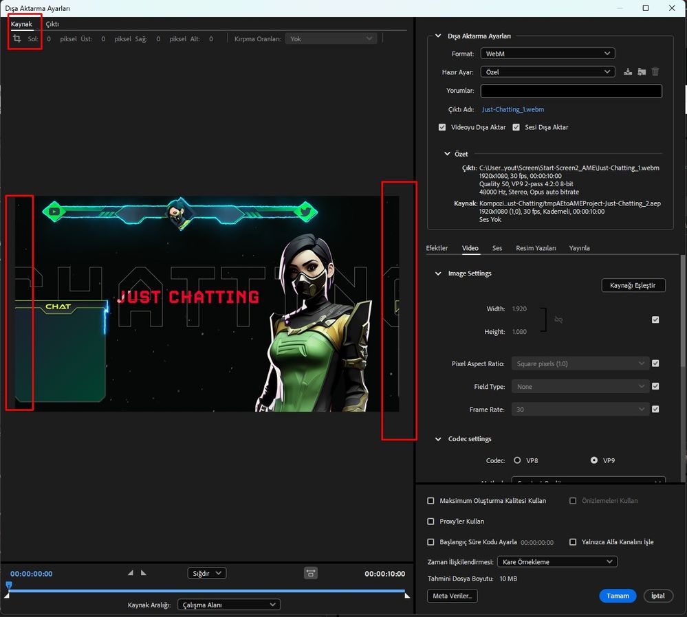

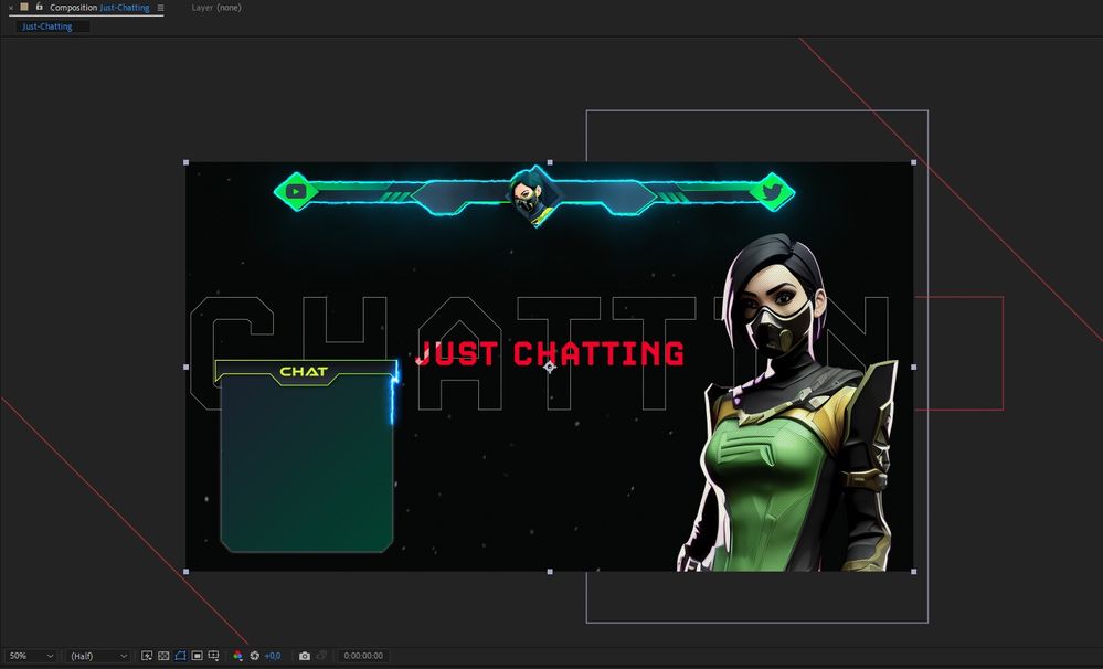

Hi
I'm not very proffessional on after effects. When I try to export my after effects composition that I prepared as 1080p, it seems to shift to the left in the source section. I checked my composition settings. Frankly, I don't know where else to look. Do you have any idea about solving this? I'm posting screenshots.
