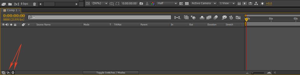

I just seeing this now, Maybe everybody already knows the answer or solution for this problem, Pls check these two functions are on, Thank.Solution.jpg

Aug 24, 2020 Aug 24, 2020
Those two switches are for the Modes column (pane) and the In/Out/Duration/Stretch columns (pane). They have nothing at all to do with the time display.
Community Beginner ,
Hello Rick!
Thank you for your incredibly constructive response! I will reiterate that out of every method suggested, this is the only one that had any effect on my being able to see seconds. After responding, I realized that it has to do with the amount of space there is for the different sections to occupy and I found that resizing the After Effects window also works.
Cheers!
