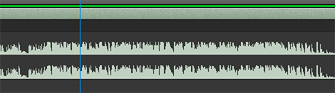

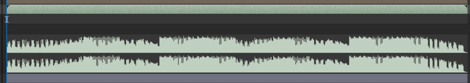

Your waveform shows me that your audio levels are too high.
Your waveform:
Properly produced music track:
Notice that there is a lot more empty space between the left and right channels. You don't have a lot of hard clipping but levels are way too high for video production.
Recommended average level for digital audio is -18 to - 12. Your audio should never go above -6. It looks like you need to do a little studying on audio production. If you want to really drive up the bass and still get audio that will sound  good you need to learn how to use multi band compressor limiters. Audition is a good tool for this. I don't know much about Audacity but I can tell from looking at your waveform that your audio was not correctly mixed. There are also loudness (a technical audio characteristic) values to consider when mixing and equalizing audio. It looks to me like you need to do some studying.

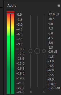

Ok, so i lowered the levels to -50 but it still distorts. The waveforms have dropped very low but i'm still getting distortion. I'll re-try boosting it in Audacity but this time i'll make sure nothing goes over -6 and aim for the sweet spot between -18 to -12. I am running the latest version of After Effects which is 14.2.1.34 on CC 2017.
Here is what the Audio and Waveforms look like at -50:
Although distortion is an issue i will try again with Audacity and see if that fixes it.
