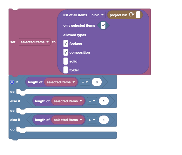

And so anyone can see how it's done, here's what I came up with. For no selected footage, it runs one function block, for when one footage is selected, it runs another, and it puts up an alert dialog reporting that there is more than one footage is selected.

Extra tip: You can save your list in a variable to make the code more compact (and also execute a tiny bit faster, since the list needs to be calculated only once):

This is even better!
I did note when implementing this idea that using the "length of" block was unnecessary, since the "selected items" list produces a number.
