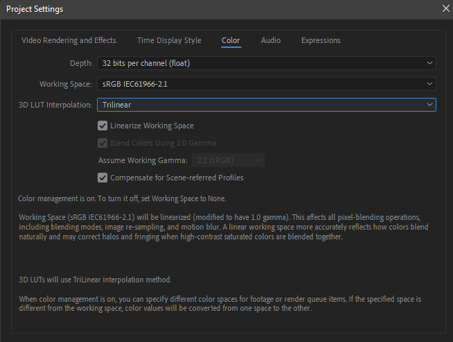

These are my project settings. Also, changing to "none" doesn't fix the problem.
project settingsproject settings

I managed to remove the banding on playback, the only way I found is to turn AE color management OFF (none), or untick "view > use display color management".
- Display is true 10-bit so that's the 10-bit settings in the Nvidia settings (as I know you need to force it in the nvidia panel to get 10-bit output from Windows otherwise will always output 8bit by default).
- Using factory sRgb preset on the display, which is quite accurate (tested with my probe and displaycal). Not looking for 100% standard so I'm happy with that without having to mess with calibrations.
- Output is via displayport (1.2 so supports 10-bit@100hz).
But the same issue happens also switching to "default color settings" and removing all "forced" nvidia settings, so maybe color profile or nvidia settings are not part of the problem.
The issue happens with all kinds of projects/resolutions, so the specific project I've exported the frame from is not relevant.
I usually work at 1080p / 25fps / 32bit, color management settings sRgb (linear off) as posted above.
