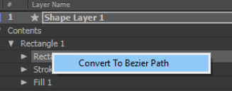

right click on the parametric path's name and you will see it
Participant ,
Aug 18, 2017 Aug 18, 2017
I think I found it. It's by right-clicking on the Ellipse Path and selecting "Convert to bezier path".

Just to be clear here's how you go from a parametric shape to a bezier path and convert that path to mask so the position, size and rotation match up.
  1. Create your text layer and do not scale it, rotate it or re-position the text
  2. Draw your parametric shape exactly the way you want it. You can move it and transform the shape with the transform shape to get it precisely in position over the text but you can  to use layer transformations of position, scale or rotation to position the shape layer.
  3. When the parametric shape is exactly where you want it to be over the text you right click on the shape and select Convert to Bezier path, click on the path stopwatch and set a path keyframe then copy to make sure that you have the path selected and the path data properly selected.
  4. Activate the text layer by clicking on the layer in the timeline, change to the pen tool bye pressing the letter g then click anywhere on the text layer to start creating a path and then paste. This is the only way you can accurately line up the mask path with the original parametric shape you created.
