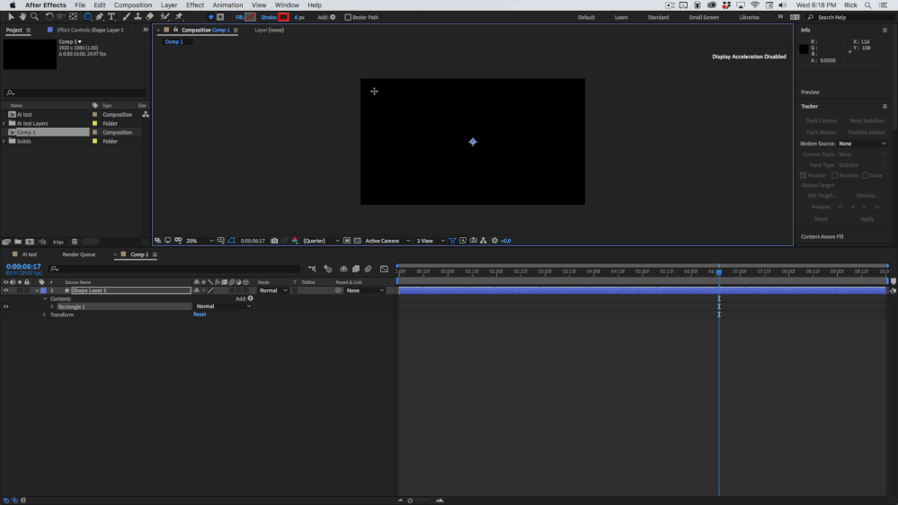

The gif shows you everything that I did to create the comp. All the modified properties of all the elements are shown. If you save the gif and open it in Photoshop you will be able to look carefully at each frame.
Aug 08, 2020 Aug 08, 2020
I opened up the Gif in Photoshop and slowed down some of the frames so you can clearly see the workflow.
New Rounded Rectangle, uu to reveal all modified properties, select Rectangle 1, Ctrl/Cmnd + d to duplicate it, Add: Trim Paths to Rectangle 2 on top, go to Rectangle 2>Stroke and increase the width, Go to the Start and End points of the Trim Paths to set the length of the thicker line, set a couple of keyframes for offset. It should take you about 2 minutes:
