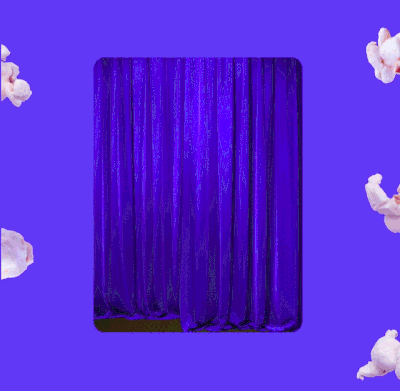

True pros!!@Warren Heaton @Rick Gerard Can't thank you enough!! â€ƒ
was able to create this effortlessly
