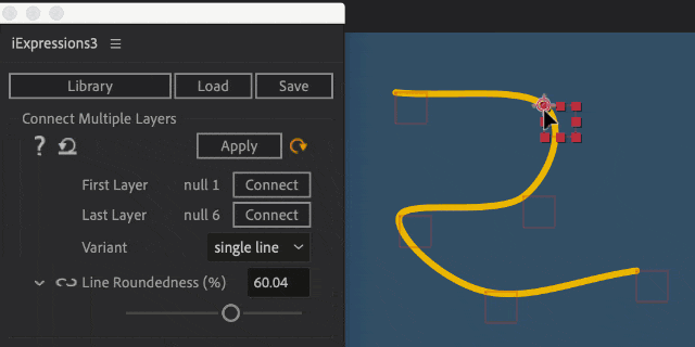

What @Jose Panadero explained is a good solution if you want to animate the shape and the circles should follow.
If you want to animate the circle layers and the shape should follow, you can also do this with Null's From Path, but it has the disadvantage that it can only connect the circle positions with straight lines, whereas your example looks curved.
My (paid) extension iExpressions contains the Connect Multiple Layers iExpression, which can also create a curved path that follows the positions of your circle layers.
Here I just have some null layers and the shape follows them, when I move the nulls:
iexpressionsconnectlayers_variant_overviews_gif
See this tutorial:
