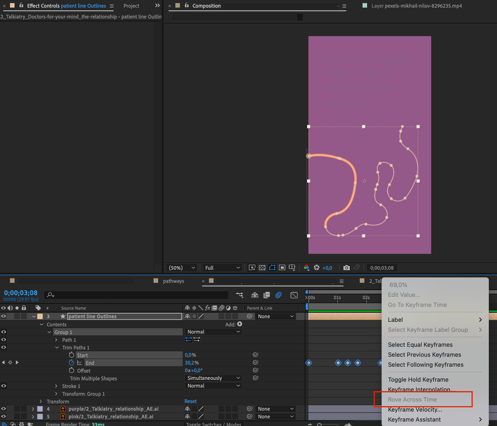

I'm trying to animate a complex line's end going back and forward. I need it to have a logical, constant speed, but the "rove accross time" function is greyed out...
Does anybody know how to do this?

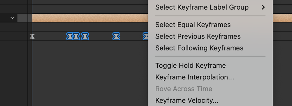

Nov 02, 2022 Nov 02, 2022
Still not working... 😞
LEGEND ,
My mistake. Rove only works for 2D and 3D properties as otherwise there's no way to calculate a speed vector. Refer to this:

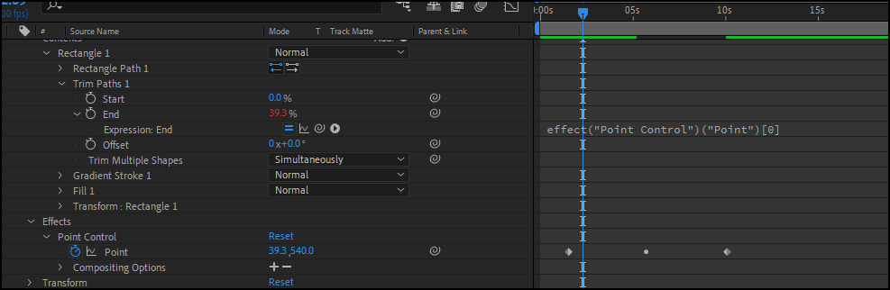

I think Rove Across Time is programmed to only work with position values... but there is a way if you're up for a little bit of work.
  • Add a Point control to your layer
  • Set keyframes to match the times of your trim paths, setting the X value to match the percentages
  • Select all the keyframes on the point control and choose "Rove Across Time"
  • Use the Trim Paths pickwhip to link the X value of your point control
Not exactly elegant, but it gets the job done.
