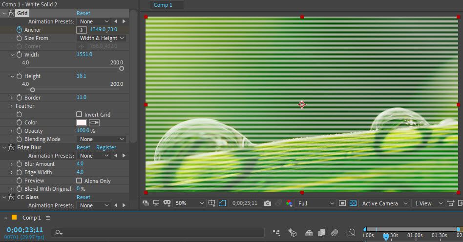

Sorry, I didn't explain very well what I was trying to do.
This is more of what I was wanting (see screen shot). Then I want those lines to continuously loop from bottom to top seamlessly.
People's Champ ,
Feb 17, 2021 Feb 17, 2021
Ah.  You can use the Generate Grid effect on a solid and animate the
Y anchorpoint (in the effects settings, not the layer).
Actuallyit's the Grid effect under the sub-category Generate in the effects menu.
To get rid of the verticle grid lines just set the width slider to a very high number (youll have to enter it manually)
And then adjust the X Anchor position (again, in the effect settings) until the verticle lines are off screen.
To unlock the Width and Height sliders you'll need to set "Size From" to Width & Height Sliders.
That should do it.  Then whatever effects and final touches for the look

Explorer ,
Awesome, Thanks!

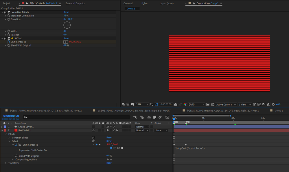

Effect>Transition>Venetian Blinds is what I used to use for creating such an effect. Then, to create the upward movement and the loop' apply Effect>Distort>Offset. It should be obvious you'll need to keyframe the Shift Center To (STC) property and only its y-parameter needs to change value between the two keyframes. What's not so obvious is with creating the looping feature.
To loop the offset, the x/y parameter needs to be change in 50% increments of its original dimension. If you right click on the STC property label, you can select Edit Value to invoke the dialog window to input your values. Here, you change the Units to "% of Source". As long as the value change between the two keyframes, for one or both parameters is a multiple of 50% of Source, you will obtain an animated loop.

Everything works except the loop, so I guess I'm not understanding that last part with the 50% offset.  When the time indicator hits the 2nd keyframe, then animation stops.
Valorous Hero ,
Feb 18, 2021 Feb 18, 2021
A more efficient method is required if you want a loopable sequence.
The Image Below shows the setup at the start of the loop. The second keyframe value for Shift Center To is [960,500]. This moves the lines upwars by forty pixels; and the two keyframes are 10 frames apart. You can adjust the time difference of the two keyframes to speed up or slow down the movement. The value change of 40 (going from 540 to 500 for the y-parameter) is based on the Width property of the Venetian Blind effect – with the y-movement set equal to the Width of the Venetian Blinds, we're ensured the two keyframes will provide identical visuals.
To complete the loop sequence, add the Expression,
loopOut("continue")
HTH

Explorer ,
Feb 19, 2021 Feb 19, 2021
That's Awesome! It worked perfectly.
Thanks for your help on this.

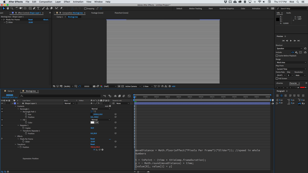

My approach to this problem is a little different and extremely easy.
  1. Create one line at the top of a new shape layer
  2. Add the repeater and adjust the number of copies to fill the screen plus 1 line
  3. Animate offset to move the line up until copy 2 is in the exact same position as line 1 was on the first frame and park the CTI (time indicator) there (I use an expression that I will include)
  4. Set the out point of the layer
  5. Pre-compose trimming the comp to the length of the layer
  6. Apply Time Remapping to the nested comp
  7. Add a new Time Remapping keyframe on the last frame of the layer using the diamond icon in the timeline
  8. Press K again to go to the last time remapping keyframe and delete it using the diamond icon again
  9. add the expression loopOut() to time remapping - because the first and last frames are identical the animation will loop seamlessly forever.
There you go. Takes about 1 minute.
The expression that makes the layer move exactly an even number of pixels per frame; very important to prevent judder, and it also works for title rolls. An expression slider controls the speed.
moveDistance = Math.floor(effect("Pixels Per Frame")("Slider")); //speed in whole numbers
t = inPoint - (time * thisComp.frameDuration);
y = - Math.round(moveDistance) * time;
[value[0], value[1] + y]
The screenshots - The animated lines comp:
The main comp; note how long it takes to render a speed change. Only the new frames then the whole timeline is ready to go.
The main advantage to this method:
  • You can adjust the timing of the nested comp by simply moving the time remapping keyframe and the motion will not result in judder problems
  • No judder or aliasing problems in the moving lines
  • Very fast to render because only a few frames and one shape needs to be calculated
  • Effects can be applied directly to the pre-comp also saving render time
Here's the project file: Rolling Scanlines.aep
