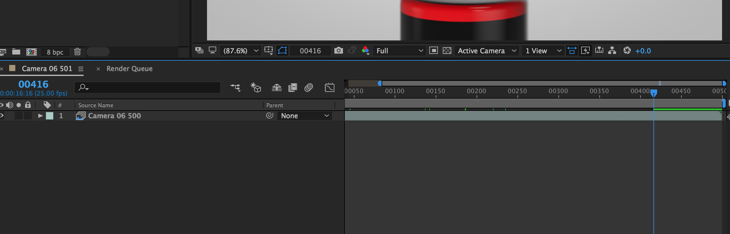

When the sequence is placed into the comp the timeline shows the full sequence but when viewed the last 16% is not visible.
The sequence is not distributed over the timeframe, it's just the last frames missing.
It appears there must be something somewhere that's conflicting. Interestingly, the frame rate of 25fps is approx 84% of 30fps.
It's almost as if AE imports at 25fps but assumes 30fps.

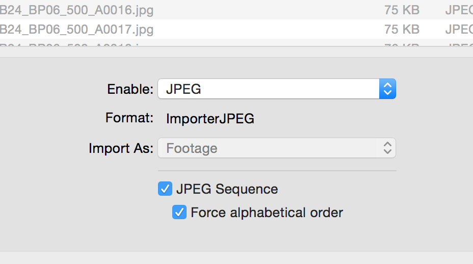

Please see attachments for import process:
You'll notice import prefs are set to 25fps
Image sequence and order selected
Comp is at 25fps duration at 500
Frame 416 has content 417 does not yet the sequence goes to 500.
Anything I'm missing?

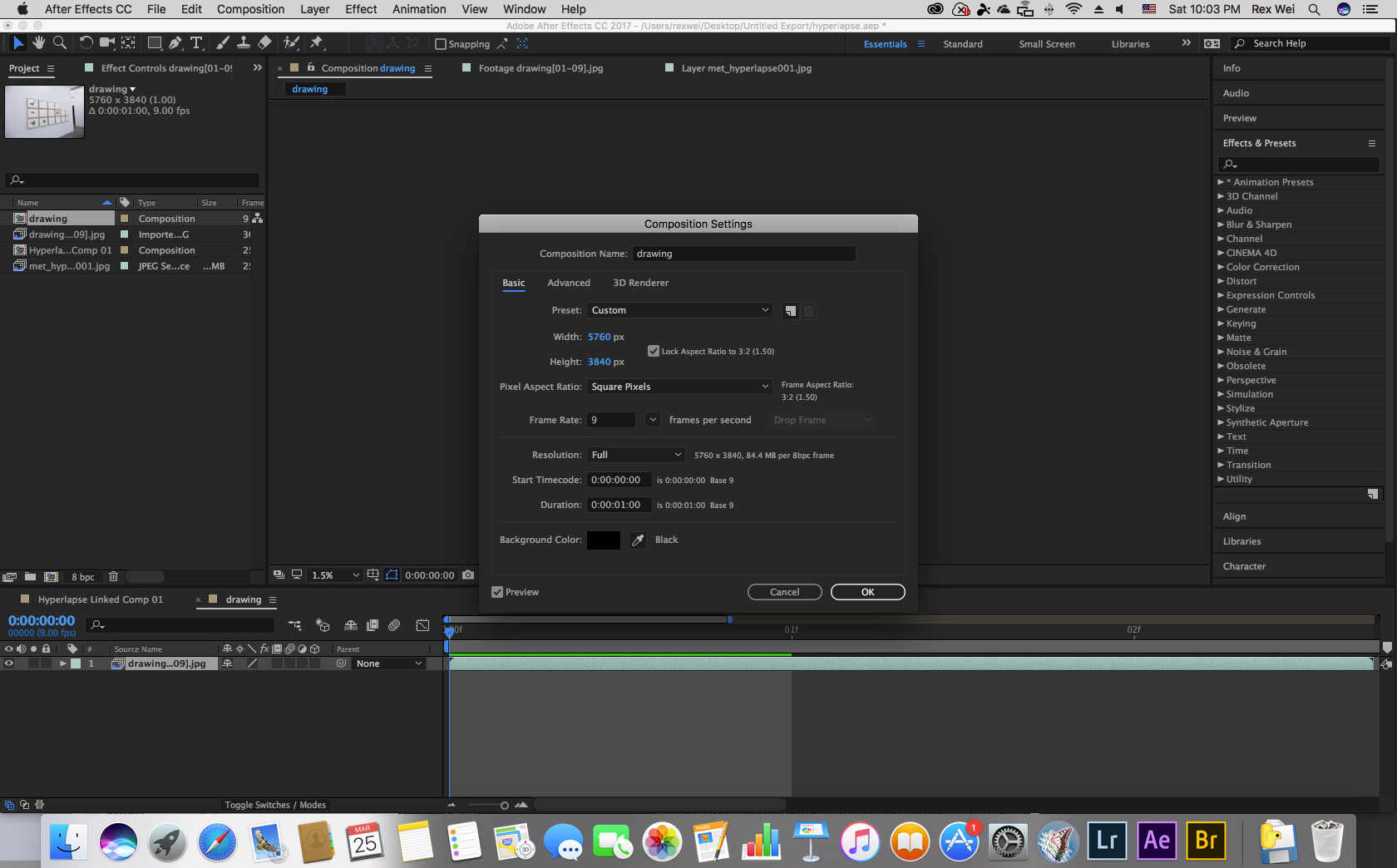

Hi there, thanks for replying. So here's a few screenshots:
Loading the shots in:
Checking the source image sequence - 9 files seems okay...(ignore the tracker points - that is for another comp)
Dragged to create new comp - 9 frames still okay...
Reinterpreting to 9fps
Now, checking the timeline in the comp, I saw that only 3 frames remain! Why?

I have tested and it looks fine here:
your workflow should be this:
1. import the files as a sequence - does not matter if it's importerjpeg or jpeg
2. right click on the sequence in the project panel and choose interpret footage->main. now change the frame rate to 9 fps
3. create a composition from that sequence by right clicking->make comp from selection or drag the sequence to the create new composition icon at the bottom of the project panel.
Community Beginner ,
Mar 27, 2017 Mar 27, 2017
Ahhh that's why. I screwed up step 2 because I didn't interpret it at 9fps in the original import...
Thanks!
