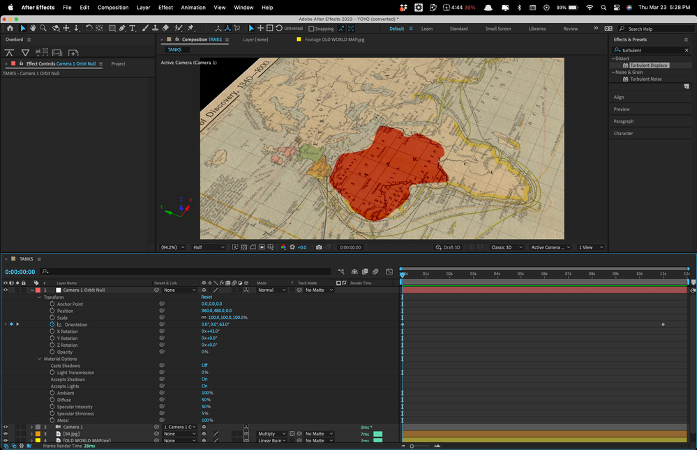

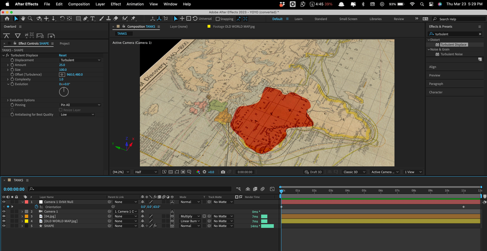

Hi Mylenium, hi Rick, terribly sorry it took me this long to reply. I just did another AE map animation. Same issue as before - layer seems to wobble with camera animation when "Turbulent Displace" or "Roughen Edges" effects are applied to said layer.  No issues when it's the layer by itself with no effects. Please see the pics below showing what's going on in my timeline with my layers and the link to the video file in question. Let me know if you have any issue accessing the video:
https://www.youtube.com/watch?v=XqeQqlY2KDs
Screenshot 2023-03-23 at 5.29.32 PM.pngScreenshot 2023-03-23 at 5.28.23 PM.png

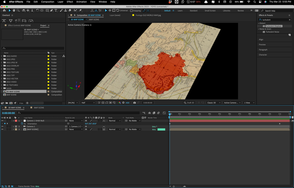

Update: I just realized that if I precomp my 3D layers, the issue goes away. No issues with any effect in the precomped final timeline. Was that the issue? That for some effects to playback properly in a 3D scene, the layers need to be pre-comped?
