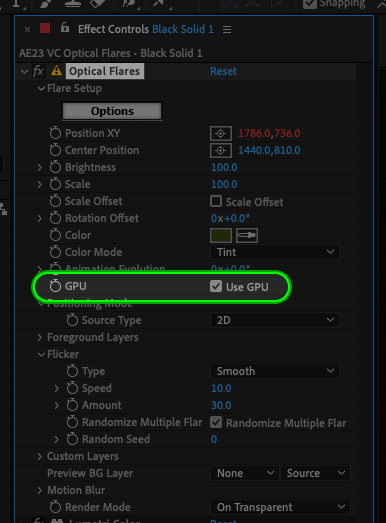

Try opening a project that uses Optical Flares with caps-lock enabled.  Locate the GPU parameter for Optical Flares and uncheck "Use GPU".  Save and then release caps-lock.
After Effects 2023 > Effect Controls > Optical Flares > GPU > Use GPUAfter Effects 2023 > Effect Controls > Optical Flares > GPU > Use GPU
This has helped me with unexpected crashes with effects that use the GPU until I've been able to sort out the display driver.

Thanks for that hint, but nope, didn't work. I tried it, but AE crashed before the project even opened. As soon as AE realizes, that there is Optical Flares involved, it denies and crashes 😄 It's not crashing when loading a frame which uses OF, it crashes before...

If it crashed, I'm guessing you never got as far as unchecking Use GPU.
Try opening the After Effects project without any source footage (so it all shows as missing) to see if you can get to the Use GPU setting.
