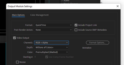

RGB + Alpha doesn't show unless you switch out the Format then back again.
Engaged ,
Dec 03, 2021 Dec 03, 2021
Look at the photos from 1 then 2 then 3.  RGB + Alpha is greyed out unless I go to something else like AIFF then back to RGB + Alpha.  Why does it matter?  Because I cannot have the transparent background and use whatever I have w/ no background as an "overlay" which is the Whole point of this the AE project in the first place.
In Image 1 you have the output format set as Quicktime ProRes 422.  Quicktime ProRes 422 doesn't support alpha channels.  That's why its greyed out.
I'm assuming that after you switch the output format to AIFF, you then switch back to a format that does support alpha channels, such as Quicktime ProRes 4444.  Perhaps you're using a preset or Output Module to switch back, but I can't tell from your Image 3 because you've cropped that out.
The CODEC selected under Format Options... needs to support RGB+Alpha.  This applies to any Format/CODEC combination in AE.
Right now you're set to Apple ProRes 422 which support RGB or Alpha, but not both.
Click Format Options... and change the CODEC to Apple ProRes 4444 which supports RGB+Alpha.
You don't have to use Apple ProRes 4444, but you do need to pick format settings that support an Alpha Channel.  After Effects can't magically put an Alpha in a format that doesn't support it.
That said, sometimes we need an alpha and also need to render to formats that don't support one.  If that's the case, choose Edit > Add Output Module after you've added the Comp to the Render Queue.  Set the first Output Module as the RGB pass and the second as the Alpha Only pass.  It's common to name the Alpha pass exactly the same as the RGB pass with "_matte" added at the end of the filename.  In video editing, the Alpha Only version is sometimes called a "Hold Out Matte".

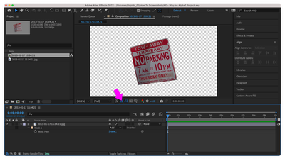

Hello @iccolor
When you enable the Transparency Grid in the Composition panel, do you see the checkboard?
  • Yes?  Proceed to next question.
  • No?  Edit your Composition such that you see the Transparancy Grid, then proceed to next question.
After Effects with the Transparency Grid in then Composition panel enabled.After Effects with the Transparency Grid in then Composition panel enabled.

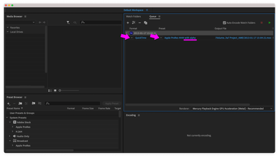

If using Adobe Media Encoder, have you chosen a Format that supports including an Alpha and have you chosen a Preset with "with alpha" in the name?
An Adobe Media Encoder render item set to "QuickTime" as the Format and "Apple ProRes 4444 with alpha" as the Preset.An Adobe Media Encoder render item set to "QuickTime" as the Format and "Apple ProRes 4444 with alpha" as the Preset.
