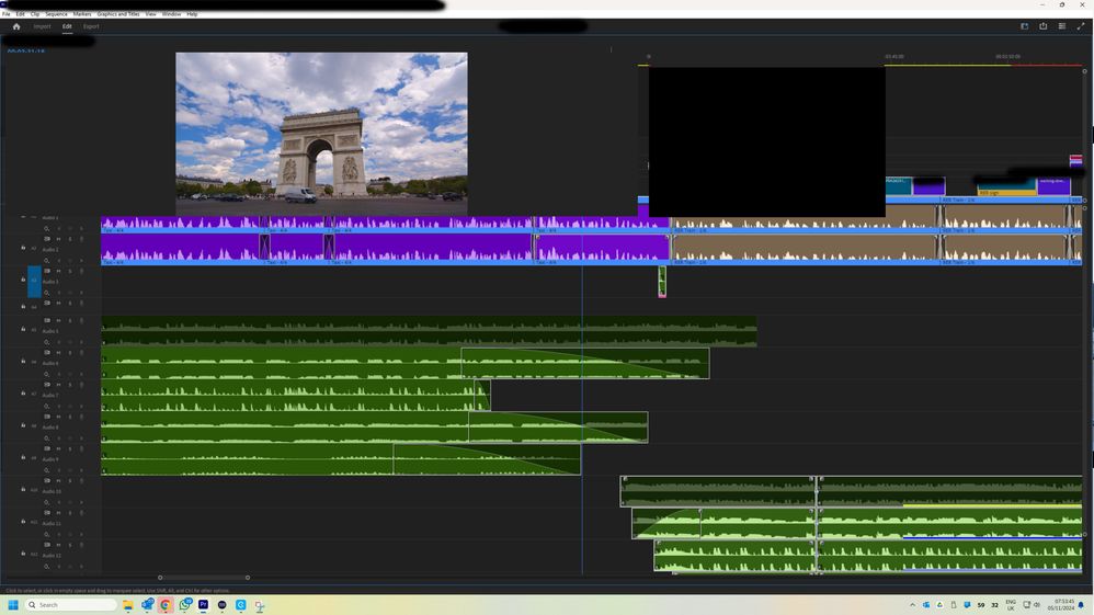

I've attached some screenshots of some crashes from today.  Not the most impressive examples (they can get much crazier!), but they hopefully give a rough idea of what I'm seeing (obviously the lines covering things like file name aren't part of the glitch).
Let me know if there's any other info that could be helpful!  Cheers
