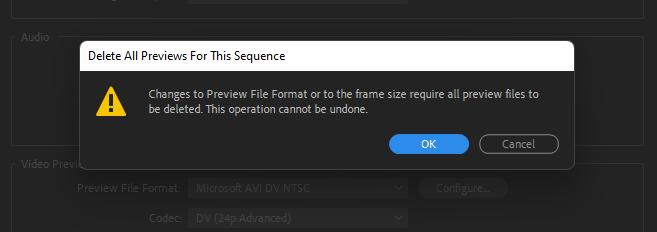

Oct 04, 2021 Oct 04, 2021
Hi! I had the same problem too but I only realized this after I exported. I tried changing the editing mode to customs and this is what showed up. What does this mean? Will any of my clips get deleted if I press ok? Thank you!

Oct 05, 2021 Oct 05, 2021
LA PLUS RÉCENTE
The preview files will be remade, if needed, with the new sequence settings. You should not lose any of your work but it might take a little while for the previews to be remade.
