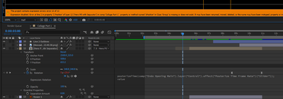

I've been working on it, so that particular layer is now 12. I've twirled down ALL properties of the layer and fully expanded the expression field for the only expression on the layer. As you can see in the screenshot, there's no yellow triangle with an exclamation mark next to it. And the warning (also shown in the screenshot, says the expression error is on the 'Z Position', and the layer doesn't have a Z position property.
The expression code for the only expression on that layer is as follows:
posterizeTime(comp("Endo Opening Main").layer("Control").effect("Posterize Time Frame Rate")("Slider"));
value
The "Posterise Time Frame Rate" slider referred to by that expression exists and this expression is working fine.

Sorry, see this screenshot instead.

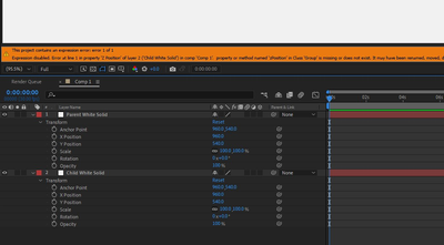

You must not have looked at the post I was referring to at the bottom of the thread with the test project. I'll paste it here and attach the project file.
As a test, I created a fresh new project and a new comp. In the comp I added two solids. I made the solids 3D layers, and pickwhipped the Z position of one solid to the Z position of the other solid (see screenshot 1).
Then I turned off the 3D layer switch for both layers and am now getting an expression error warning (see screenshot 2).

This must be a bug.

Does anyone have any input on this? I'm in the middle of  big project and I can't get the warning banner to go away and so I'm not getting legit warnings in the case of a real broken expression.
Attached is a project file (containing only two solids and a single comp) demonstrating this issue.
