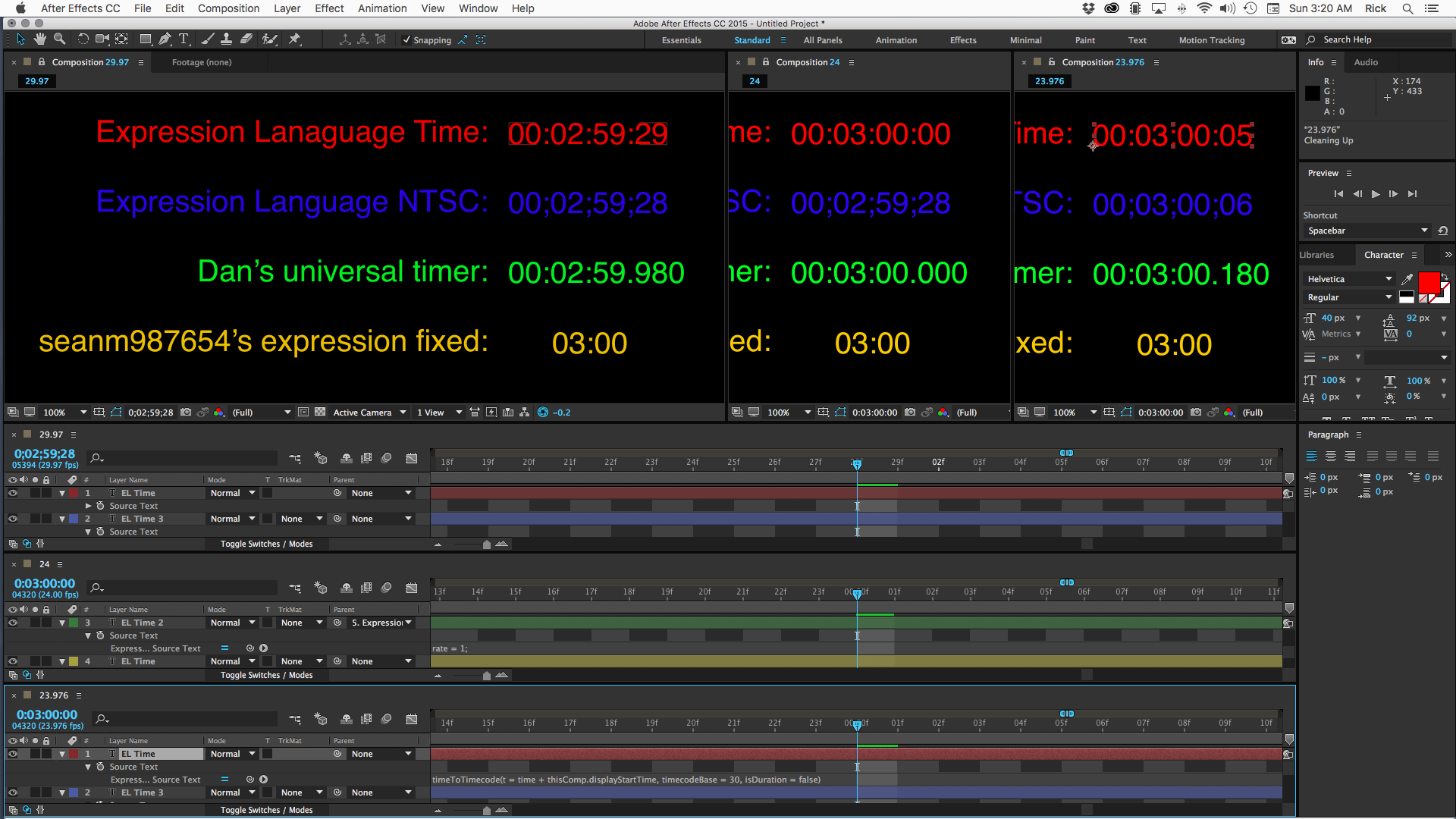

First, Adding a video to the timeline has nothing to do with the time display at all. If you have a video of a known length, say 3 minutes, and it is properly interpreted you can drop it in any comp, even one that is 10 fps, and it will still playback at the right speed. There was no need for you to add a video to your test. All you need be concerned with in this problem is the display of the comp time and frame number as it relates to true time. Let me talk about this example set of comps:
First let's talk about how the CTI works in conjunction with an entered time. If your comp is set to 29.97 (or any fractional time base) and you type 3;00;00 and the comp is set to drop frame timecode as it should be, AE will round down the time you entered and position the CTI on the frame that is nearest to 3 seconds giving time for the last frame to playback. This means that when your comp is set to 29.97 the nearest frame to 3 seconds is 2;29;28 because frame 2;29;29 would actually last approximately .02 seconds longer than 3 seconds. If you submit a program or commercial to a broadcaster that is 1 frame longer or even .02 seconds longer than it should be it may be rejected. When the frame rate is 24 or 23.976 drop frame time display is not an option. It only works with 29.97 or 59.94. If you are not using Drop Frame timecode display the rounding is disabled so you end up at 3:00:00. That's how it works with all NLE's and all compositing apps because that's the standard as written by SMPTE. This math is correct and has been industry standard forever. When you have drop-frame timecode selected and you zoom into the timeline all the way the 'dropped' frame number is highlighted. It's always going to be after the nearest whole second and always be 02 in a 29.97 comp.
NON DROP frame timecode never gives the correct time after the first minute. If you use non drop frame timecode display and your timeline is longer than 1 minute the time display and true running time of your comp will always be incorrect. There is no practical reason at all for using non-drop frame timecode. The need for non-drop frame timecode went away with the demise editing video tape with magnetic powder and a razor blade and digital control of tape decks. It was never used for timing a program because the running time in hours, minutes and seconds after 1 minute is always wrong.
The default time base for Time to Time code is 30 fps. If you want that to give you frame numbers at different frame rates you need to change that. Set it to 24 for your 24 fps comp. This method will not give you the correct frame number in a 23.976 comp because those comps are not set to drop-frame timecode and the method assumes that they are whole frame numbers. It's a bug in the method. You can see that in the 23.976 comp on the right. The frame count at three seconds is off by five.
Now let's talk about the NTSC default expression language method. The default the NTSC method is non drop frame. You have to change that to drop frame by changing the nonDropFrame to true to display the correct time for NTSC (29.97 or 59.94) drop frame comp.
This method will display the correct time and frame number plus one because it does not round down. The fractional frame rates like 23.976 will be off in the frame count because there has been no provision in the method for 23.976 fps which are not interpreted as drop frame for the purposes of the method. Currently there is no automatic precise way to get a drop frame frame count in a comp that is 23.976 fps. If you apply the NTSC method set to drop frame then you won't get the correct frame count for the 23.976 comp, you'll get the correct frame count if the comp was 29.96 drop frame. You can get the proper frame count for any frame rate comp by combining 1/this.Comp.frameDuration with some other math but I won't go into that now. Let's just say that it's a modification of Dan's universal timer that changes milliseconds to frames.
Dan's expression will always give you the correct running time of the composition including the last frame no matter what the frame rate of the comp because it works strictly on time. The differences in the time display for the tree comps using Dan's expression is the difference in the length of time it will take the last frame to play. As long as you set the speed to 1 and the starting time to 0 Dan's expression will always give you the correct running time of the comp. In your example showing a difference in the timeline and the displayed time from Dan's expression you are not taking into account the duration of the last frame. Dan's method is correct because it always displays the current time of the composition including the time it takes to playback the last frame.
Last example. I originally wrote that you could correct seanm987654's expression by changing 59 to 59.94 I was not correct. His expression just doesn't work. It appears to work when you set the CTI to 3;00;00 but if you back down the count goes from 3:00 to 3:60 then on down so the true time is never displayed. With a little head scratching I could make the idea work but it's just not worth it. I should have caught that problem but I didn't take the time to really think about the math.
The original question was how to fix the time display in a 29.97 comp - That's been answered.
