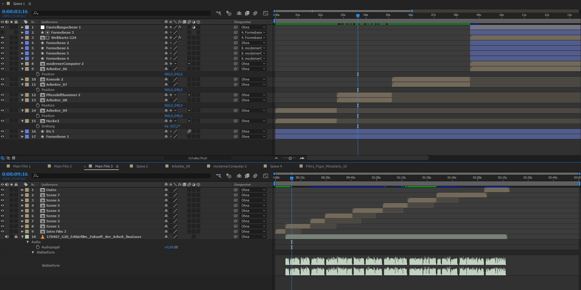

Mentor ,
Apr 18, 2017 Apr 18, 2017
I simple drag the main-comp beneath the pre-comp. So I see two comps open on my screen. Than I go to the beat, or audio-point on the maincomp and have the playhead at its right position in the pre-comp.
Every pre-comp can start at 0, which is quiet useful for some effects.
