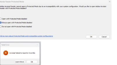

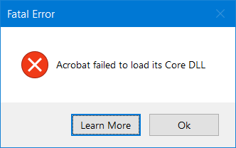

Hi
In our Enterprise we Upgrade Adobe Reader x86 from 25.1.20813.0 to 25.1.20982.0.
After that most but not all client (W10 and W11) can't open Adobe Reader and get the following errors
or in Browser
What should I do to fix this?

Symptoms (from your screenshots):
  • AppContainer–Inkompatibilität im geschützten Modus prompt
  • “Es ist ein Problem … (103:103)” restart message
These indicate the Reader is failing to start inside AppContainer while Protected Mode is enabled after the upgrade. This is commonly due to endpoint security or policy conflicts

Hi AnandSri
Thanks for your replay.
  • Are you using any specific deployment method (e.g., SCCM, Intune, GPO) to push the update to the Reader?
    I create an admin Install Point and the client take the update at next boot. This works for the last 10 years well.
  • Are there any custom security settings custom security settings or AppLocker/Defender or AppLocker/Defender configurations applied in your environment?
    There are lots of custom security settings and AppLocker and Defender in our environment. This as before.
  • Can you confirm whether Protected Mode is enabled by default for all users?
    Protected Mode is enabled by GPO.
  • Does the issue occur only when opening Reader directly, or also when opening PDFs in the browser?
    In both cases. On Message is when opening Reader directly and the other when opening PDFs in the browser.
For the last 10 years it works fine in our environment. Rollback to 25.1.20813.0 works fine in our environment

Dear Support
I rename HKEY_LOCAL_MACHINE\SOFTWARE\Policies\Adobe to Adobe$ so no policies exist until next refresh.
I get AppContainer–Inkompatibilität im geschützten Modus prompt as above.
I set HKEY_LOCAL_MACHINE\SOFTWARE\Policies\Adobe\Acrobat Reader\DC\FeatureLockdown
bProtectedMode: 0
bEnableProtectedModeAppContainer: 0 or 1
I get
bProtectedMode: 1
AdobeReader does not start any more.

We are having the same issue, upgraded this morning from Adobe Acrobat Reader DC 25.001.20937 to Adobe Acrobat Reader DC 25.001.20982. We are using 32bit of Adobe Reader but have managed to get a fix by installing Microsoft Visual C++ v14 Redistributable (x86)
Adobe Employee ,
Dec 04, 2025 Dec 04, 2025
Hello @steve_5806, Thank you for sharing the workaround that It works after installing Visual C++.
@ CanRF If the issue continues, please collect the logs as mentioned in this article, and share the logs with the log ID with us for further investigations: https://adobe.ly/4iyPXPk

Thank you for the details @steve_5806 & @CanRF
We have already reported this to the product team for further investigation into the root cause. The logs help us isolate the causing module, allowing the team to work on the fix.
We will share an update as soon as we receive any information from the team. As a workaround, installing the Microsoft Visual C++ v14 Redistributable (x86) for 32-bit Acrobat Reader fixes the issue.
Hi steve
Installing of VC_redist.x86 14.50.35710.0 solves my problem.
So I must support, update VC_redist on all clients.
This is not nice.
